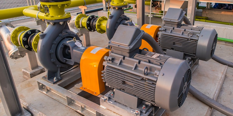

Industrial water pumps
Figure 1. Large industrial water pumps with electric motor drives. Image used courtesy of Adobe Stock

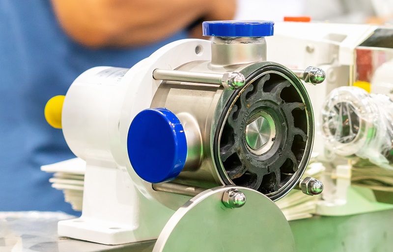

Vane Pumps
Vane pumps consist of a series of vanes that ride in slots cut into a rotor inside of an eccentricly shaped cam ring. The hydraulic fluid flows through the pump, just like water through a paddlewheel where the paddles (vanes) change in length as they move around the eccentric chamber. Sometimes, instead of rigid vanes with changing length, the pump uses rubber vanes which bend along the eccentric portion of the chamber, as shown.
Vane pump with rubber vanes
Figure 2. Rotary vane pump. Image used courtesy of Adobe Stock
Vane pumps create a constant unvarying flow rate which can be a bonus in some applications. They are also self-priming and often feature a pressure relief valve to prevent pump damage in the event that an overpressure event occurs. Vane pumps are subject to high rates of wear and may become easily damaged in scenarios where the hydraulic fluid is easily contaminated. They are often rated to produce pressure up to 3,000 PSI.

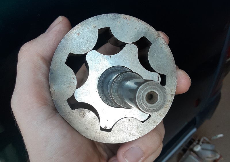

Internal gear pumps consist of two gears, a larger gear that meshes with a smaller gear inside of it. The gears are offset from the center meaning only one side is meshed and the other side contains open space for the fluid to be carried across from the inlet to the outlet as the gears spin.
Internal gear pump mechanism
Figure 3. The mechanism of an internal gear pump where the shaft is centered, but the outside gear is offset during rotation.

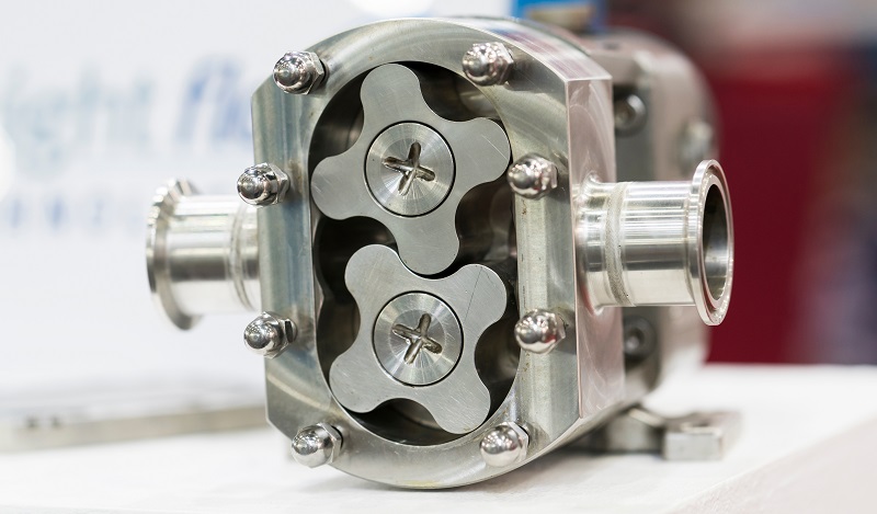

A variation of the gear pump is the rotary lobe pump which operated using the same basic principle, but employs a set of lobed rotors instead of gears, reducing the friction and wear of the components, increasing the service life.
Lobe pump mechanism
Figure 4. Rotary lobe pump. Image used courtesy of Adobe Stock
Gear pumps are efficient and carry a consistent amount of fluid per revolution. They are also resilient and can be used in applications where hydraulic contamination is a concern. They are commonly able to operate at pressures of 3,000-3,500 PSI.

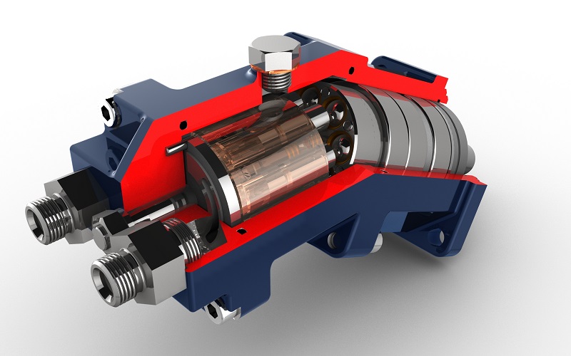

Piston Pumps
Piston pumps are a strong, low-noise type of hydraulic pump. They are capable of producing pressures of 6,000 PSI or more, making them ideal for high pressure applications.
They consist of several pistons in a ring of cylinders that rotates around a shaft. The shaft contains a plate on an angle (called a ‘swash plate’) that determines the stroke of the pistons. As the shaft rotates and the pistons ride on the inclined plate moving in and out of their cylinder. They alternate from creating a vacuum on the inlet side by increasing the volume of the cylinder for half the cycle to then decreasing the volume of the cylinder as the piston moves in the opposite direction toward the outlet thus creating pressure.
Render of a piston pump
Figure 5. Piston pump. Image used courtesy of Adobe Stock
The output of piston pumps can be changed by increasing or decreasing the angle of the inclined plate in the pump.

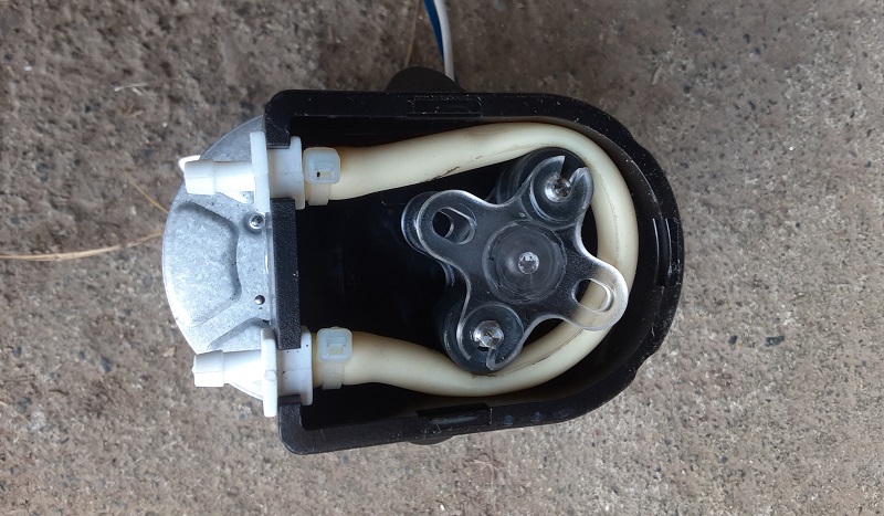

Peristaltic Pumps
In cases where the liquid must remain inside the pipe or tube to eliminate contamination (like medical or food & bev applications), there are a limited number of options. For smaller flow rates, lobes compress the flexible wall of the tube while rotating, squeezing the fluid through the tube and generating pressure and fluid flow.
Small peristaltic pump
Figure 6. Peristaltic pump with small electric motor drive.
Centrifugal Pumps
In many fluid motion systems with large volumetric output (including water delivery systems), the rotational energy is transferred to vanes inside a chamber. These vanes make up the 'impeller', forcing the fluid to the outside of the chamber, exiting through the outlet on the side. The rotational transfer of energy is similar to the operation of a centrifuge device, so these pumps are given the label of centrifugal pumps.
Due to the motion of the liquid in the impeller chamber, the flow is very rough, leading to problems of cavitation and wear on the impeller blades, reducing the lifespan of the pump. Additionally, since the motion of the impeller blades creates a suction force on the inlet in order to provide positive pressure eon the outlet, the pump must be filled with liquid in order to begin providing pressure. This process is known as 'priming' the pump. An example of a centrifugal pump is shown in Figure 1, wit hthe fluid inlet at the center of the impeller chamber, and the outlet along the left side of the chamber.
