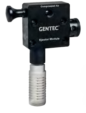

Most common are the Venturi vacuum modules which allow exhaust air to flow past a small opening, and as the air expands into the ambient open room, the pressure decreases causing a vacuum. A third opening draws in air to fill this void, creating suction. When active, they constantly drain air, so they are ideal for limited duty-cycle applications.
Example of a Venturi vacuum module. Image courtesy of Azeer.
Venturi vacuum modules also use more air for larger pressures, so the consumption is greater for larger lifting loads. But they are simple and inexpensive, which are ideal properties. This type of generator is called an ‘ejector’ since it ejects the air, and it might also have an on/off valve integrated with it. Alternatively, simply use an external value to cut off the supply and the vacuum will turn off.
Venturi air ejectors are usually limited to creating about 50 to 90 kPa, fairly close to a full vacuum, but not good enough for some cases. The size of the vacuum pad relates to how many actual lb or kg of lifting force is achieved.
