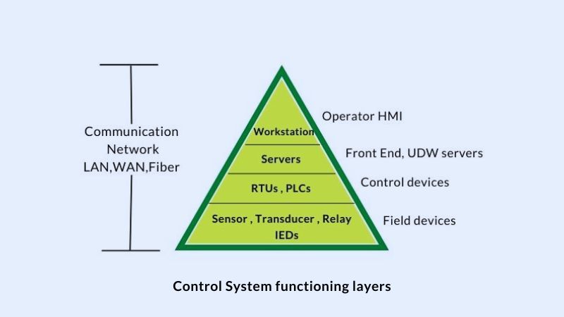

architecture of control system layers pyramid
Figure 1. Pyramid describes the general architecture of control system layers.

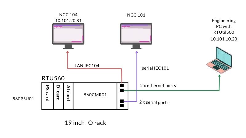

The case study is presented here on how to configure an RTU560 using RTUilt500 software installed on a separate engineering PC. The RTU560 with a 19-inch IO rack is equipped with a single power supply card, binary input card, and analog input card for I/O signals. The single 560CMR01 CPU card is equipped with 2x Ethernet and 2x serial communication ports used to communicate over  IEC101/104 protocols.
RTU560 communicating with control centers over IEC104 and IEC101
Figure 4. RTU560 communicating with control centers over IEC104 and IEC101 and engineering PC with RTUtil500 software.

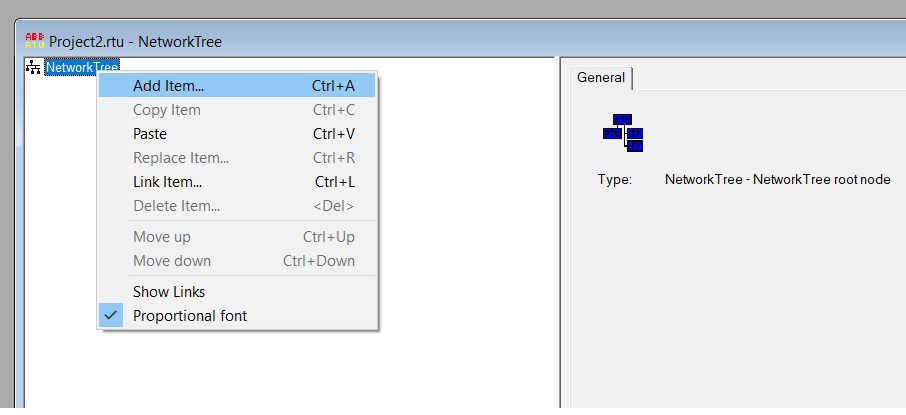

The network tree is used to build up the station network topology. Here we choose the lines and the communication protocols between the stations. The network tree is needed for routing the process data points through the RTU network, and the network tree gives an overview of a complete station network.

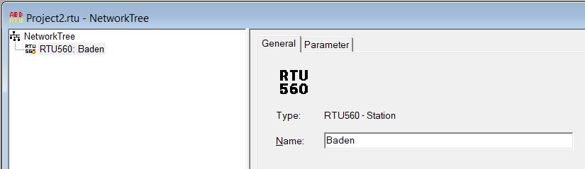

  1. First, click on “Add item” and select node RTU560 station and name it. For example, the name “Baden” is provided in the snapshots given below:
network tree structure
add node to network tree
network tree baden

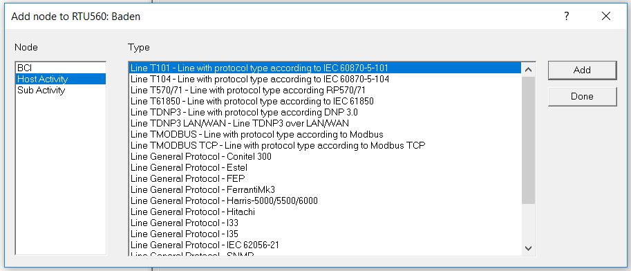

  1. To add an IEC101 line, according to our requirement, right click on “RTU560:Baden” and add the “Host Activity” node with type line T101 protocol type IEC 60870-5-101 and name it “IEC101_CC.”

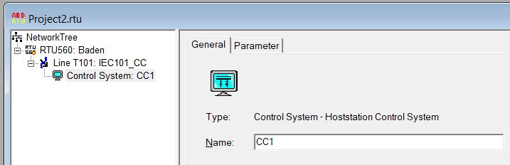

  1. Again, right click on the newly added line i.e. Line: T101:IEC101_CC, and select “Control System-Hoststaion Control System” and name it “Control System: CC1”

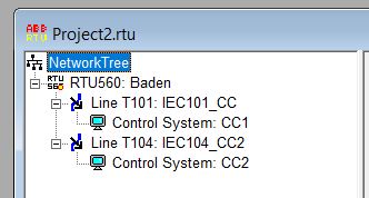

  1. The same steps are performed for setting the second communication line for a host station by selecting protocol type IEC-60870-5-104. Finally, the network tree structure should look like as below:

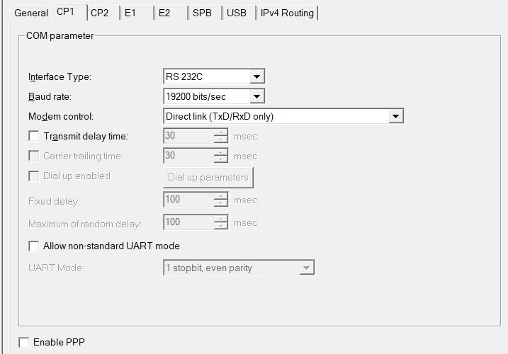

Configuration of Processor Board

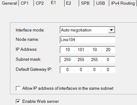

The Ethernet interface “E1” for Line 104 has been configured to download the RTU560 database over a LAN TCP/IP connection. The IP address in this example will be 10.101.10.20 for the download and the monitoring through the webserver. When the CPU has no configuration, the jumper on the CPU will provide the default IP address 192.168.0.1.
  • Click 560CRM01 and select Ethernet interface tab E1 to enter the IP address for “10.101.10.20” Subnet mask “255.255.255.0”
  • In the last step, select “E1:Line T104: IEC104_CC”, and select Master IP address “10.101.20.81”, Subnet mask “255.255.255.0”, meaning that only NCC 104 with that address can connect. If the address is left 0.0.0.0, then any NCC104 can connect within that subnet.

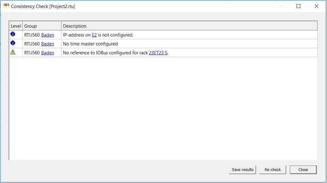

Before working with signal configuration, do a consistency check to make sure the hardware configuration has no errors. The entries in this list are linked to the nodes in the trees of the checked project. Click on a particular error and the tool will select the corresponding area where the error has been detected.
Select drop-down Menu “Project -> “Check Consistency” and double click on an error to show the corresponding window

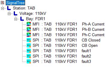

In the signal tree, the structuring of the electrical process and the naming of the signals are made. The name for every data point is derived from the structure of the electrical process. In this example, we will manually build the signal list—this process is done using an Excel sheet. The signal tree will be based on the tree structure defined in the project signal tree structure as in Figure 7.
signal tree
Now it’s time to link the signals with the appropriate AI board and DI boards respectively. After data points from the signal tree to the appropriate board in the hardware tree, the automatic protocol routing action is triggered by the linking of a data point. Right click on “23BE23” and “23AE23”, then “Link Item”  and select each signal from the drop-down list one by one.
hardware tree
