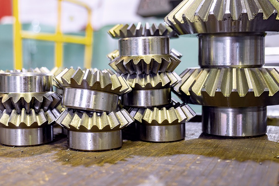

Different Angle, No Offset
Many times, the motion transmission needs to change directions. In many systems, this can be accomplished with a Universal or Constant Velocity joint. If the motion must change 90 degrees, or if it must be transmitted from a single shaft into two output shafts, then the U-joint may not (or cannot) be suited for this task.
A bevel gear allows this 90-degree alignment by containing two gears, each consisting of the lower section of a 45-degree cone (also called a ‘frustum’).
The teeth are cut into the outer edge of the 45-degree face. This allows the two 45-degree angles together to form a 90-degree angle change.
Bevel gears after manufacturing on a gear-cutting machine.
Sometimes, a custom application may use different angles, such as a pair of 22.5-degree gears to form a 45-degree bend, but this is not nearly as common. A recognizable occurrence of bevel gears would be inside a common different a rear-wheel-drive vehicle drive train.

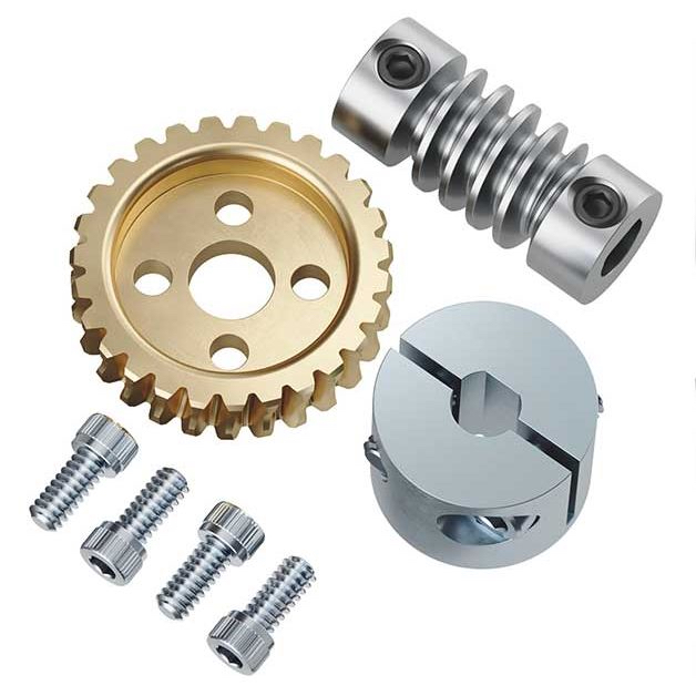

If a left and right-hand gear are used together, the shafts will be parallel just like a spur gear. With the angled teeth, it can provide less noise and vibration since there is never a gap in the contact area. The other type of gear for this scenario of 90-degree alignment is called the ‘worm’ ger set.
A worm gear set. Image courtesy of Active Robots Ltd
One gear resembles a screw with a large wrapped tooth, always on the input shaft. The output is a gear with a slight angle in the teeth matching the worm gear profile.
The output shaft will rotate very slowly, but with tremendous rotational force. This is found in all sorts of settings when a high-speed motor is meant to drive a low-speed load device, but with much greater force.

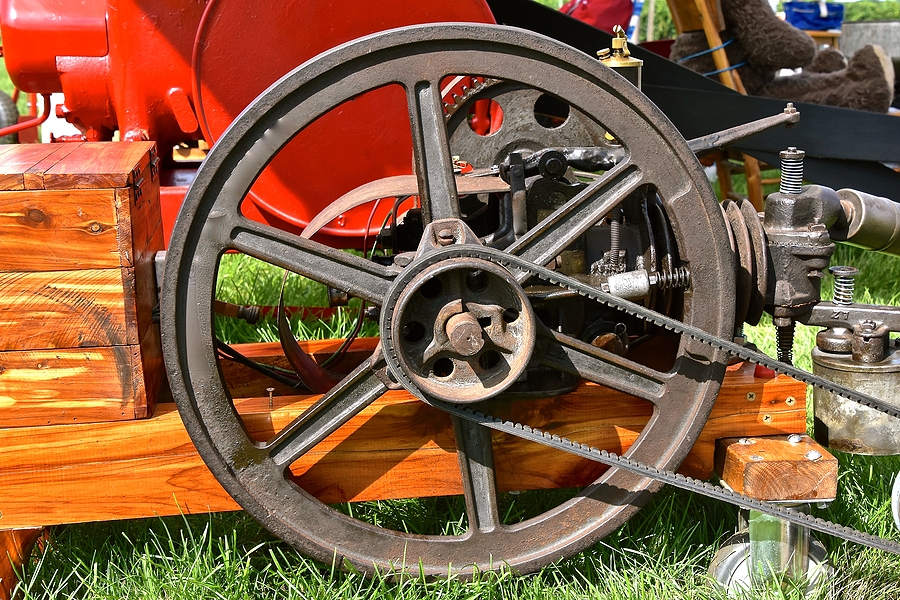

V-belts have a trapezoid shape, running inside a pulley with a V-shaped profile. The friction of the belt at high speeds allows motion transfer over a long distance. If one pulley becomes locked up, the motor may still rotate which can prevent a catastrophic motor failure.
A v-belt being used.
