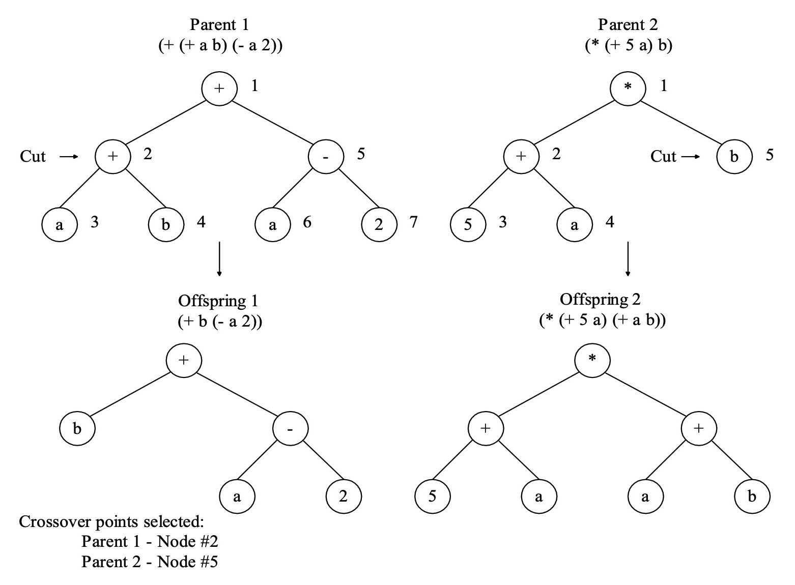

Crossover
Crossover is performed by using the selection operator to pick two-parent programs and then "mating" them.
First, a random node (locus) in each program tree is selected. Since a tree is a recursive structure, each node can be considered to be the root of some other tree, a subtree within its respective parent program tree
Note that a tree may consist of a single node as is the case when a terminal node is selected. These subtrees are exchanged thus forming two, potentially new, offspring programs, as shown in Figure 1.
Figure 1. Crossover of two programs
Crossover introduces novelty into the population. As in a genetic algorithm (GA), it is believed that over time, it becomes likely that an "offspring" program will contribute useful subtrees or "building blocks" (often referred to as "schema" in GA terminology) of genetic code that leads to increased fitness in their host programs and therefore will tend to propagate quickly.

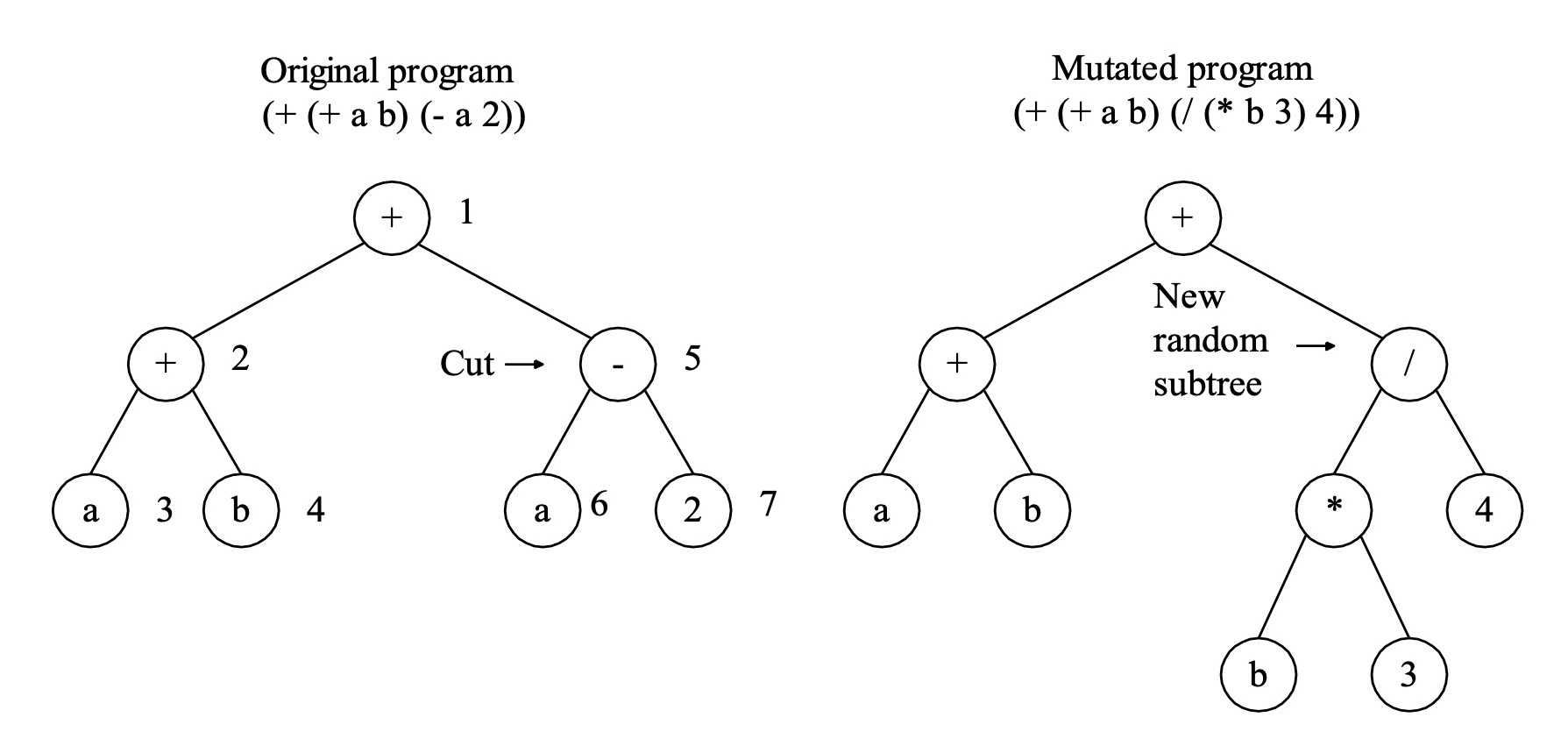

Mutation
Mutation can be performed by first randomly selecting a single program and then randomly selecting a node within that program tree. The subtree rooted at this node is then replaced by a
new randomly generated subtree, as shown in Figure 2.
Figure 2. Mutating a program. Here, mutation occurs at node #5
The main benefit of mutation is to periodically inject new genetic material (functions and terminals) that may no longer be present in the current population. The value of mutation in genetic programming (GP) is arguable and many successful results have been obtained in its absence.
