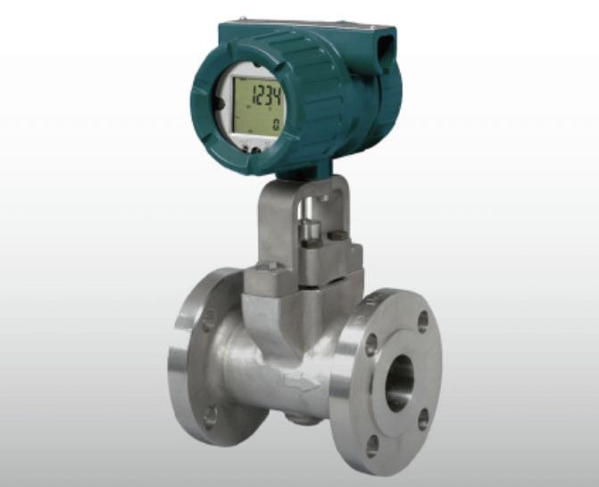

Yokogawa's digital YEWFLO series flowmeter
Figure 1. Flowmeters like Yokogawa’s digitalYEWFLO series are the kind of devices that benefit from HART protocol support. Image used courtesy of Yokogawa

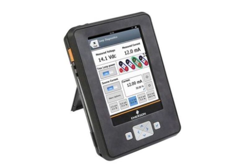

Emerson AMS Trex Device Communicator
Figure 3. The Emerson AMS Trex Device Communicator enables HART or Fieldbus module communications. Image used courtesy of Emerson

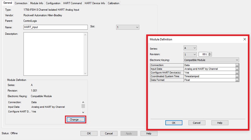

Setup and Programming HART Device (Rockwell Automation Studio 5000)
Once your device is powered on and wired to the HART analog input card, you can now configure your program to communicate with the HART device. Much like any interface card or any other device on an industrial field bus, you will need to add the device to your device tree in the program.
After giving your device a name, you will want to make sure you set the input data to ‘Analog and HART by Channel’ in the Module Definition settings, as seen in Figure 4. The next setting you need to pay attention to is on the configuration tab. This is where each channel is configured and scaled to engineering units, along with setting the type of analog signal: voltage or current.
Module Definition dialog
Figure 4. Module Definition dialog, allowing input data and configuration methods to be selected for the module. Image provided by Control.com

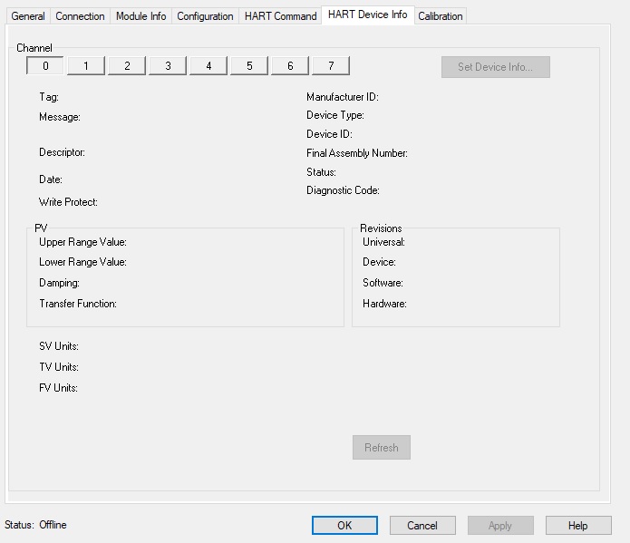

Configuration of the digital signals takes place on the ‘HART Device Info’ tab. This is where additional information about the device can be viewed and variables can be assigned to additional parameters or measured signals.
HART Device Info tab
Figure 5. HART Device Info tab, showing fields for device type, data tag association, and primary variable limits, among other data. Image provided by Control.com
