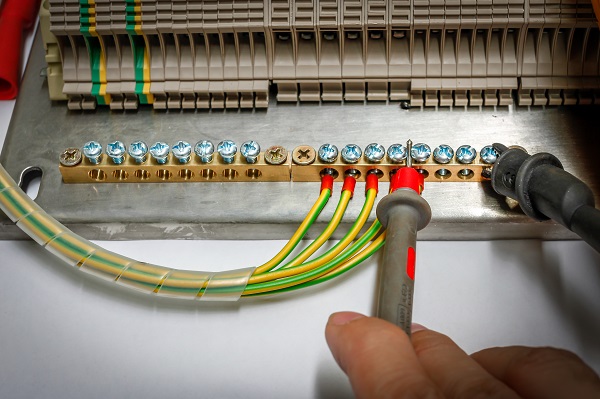

To understand why conductor sizes are provided, it’s critical to review the purpose of the ground circuit in the first place. If a live energized circuit comes into contact with a piece of metal, either in the cabinet or on the machine, there should be a safe circuit for the electrical current to travel back to the main source with sufficient magnitude to immediately trip the branch protection or special ground-fault device.
If conductors or terminals are sized too small, there will be added resistance in the circuit. The allowed current may still be fatal, even if the magnitude is well below the operating level of the equipment. For example, assume a motor uses 25 amps, limited by the resistance of the windings in the motor coils. If the grounding conductor has slightly more resistance than the windings, the circuit breaker will not trip in the event of a ground fault. Yet 25 amps is easily lethal to the next technician who unknowingly reaches out and touches the machine frame.
Ground bus bar in a panel
Figure 1. Ground distribution bus bar. Image used courtesy of Adobe Stock

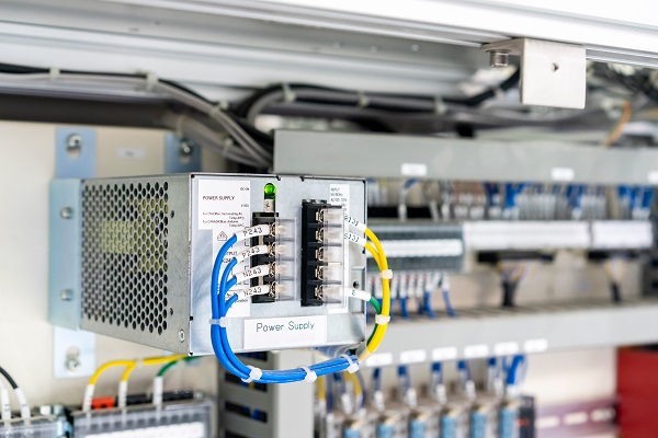

If the 24 VDC supply (or any supply/transformer with an output less than 50 volts) is supplied with any voltage above 150 volts to ground, the secondary must be grounded (Chapter 16.1.a.1).
This means that if you provide this supply with 240 VAC where one leg is grounded, or if you provide a 3-phase 480 volt input, the secondary must be grounded, as both of these situations will yield a voltage above 150 volts.
Using a high-leg delta supply, either low or high voltage will always have at least one conductor exceeding 150 volts AC. A high-voltage wye with a grounded neutral will also exceed 150 volts on every conductor, so in these supply situations, the secondary must be grounded.
When, then, is the ground conductor not required?
A power supply with a single-phase 120 volt or a low-voltage 3-phase wye supply where the neutral is grounded do not need a secondary ground as the maximum conductor voltage is below 150 volts. Likewise, in a 240 volt single-phase system, if the neutral is grounded, then neither conductor will exceed 150 volts to ground, and this does not need a secondary ground.
However, even if the supply voltage is small, if it is ungrounded, then the power supply secondary must be grounded (Chapter 16.1.a.2). This guideline does not distinguish between AC or DC sources, so a power supply that uses an ungrounded DC input must also be grounded at the secondary side.
Power supply in a cabinet
Figure 3. Power supply with an input below 150 volts AC. Image used courtesy of Adobe Stock
