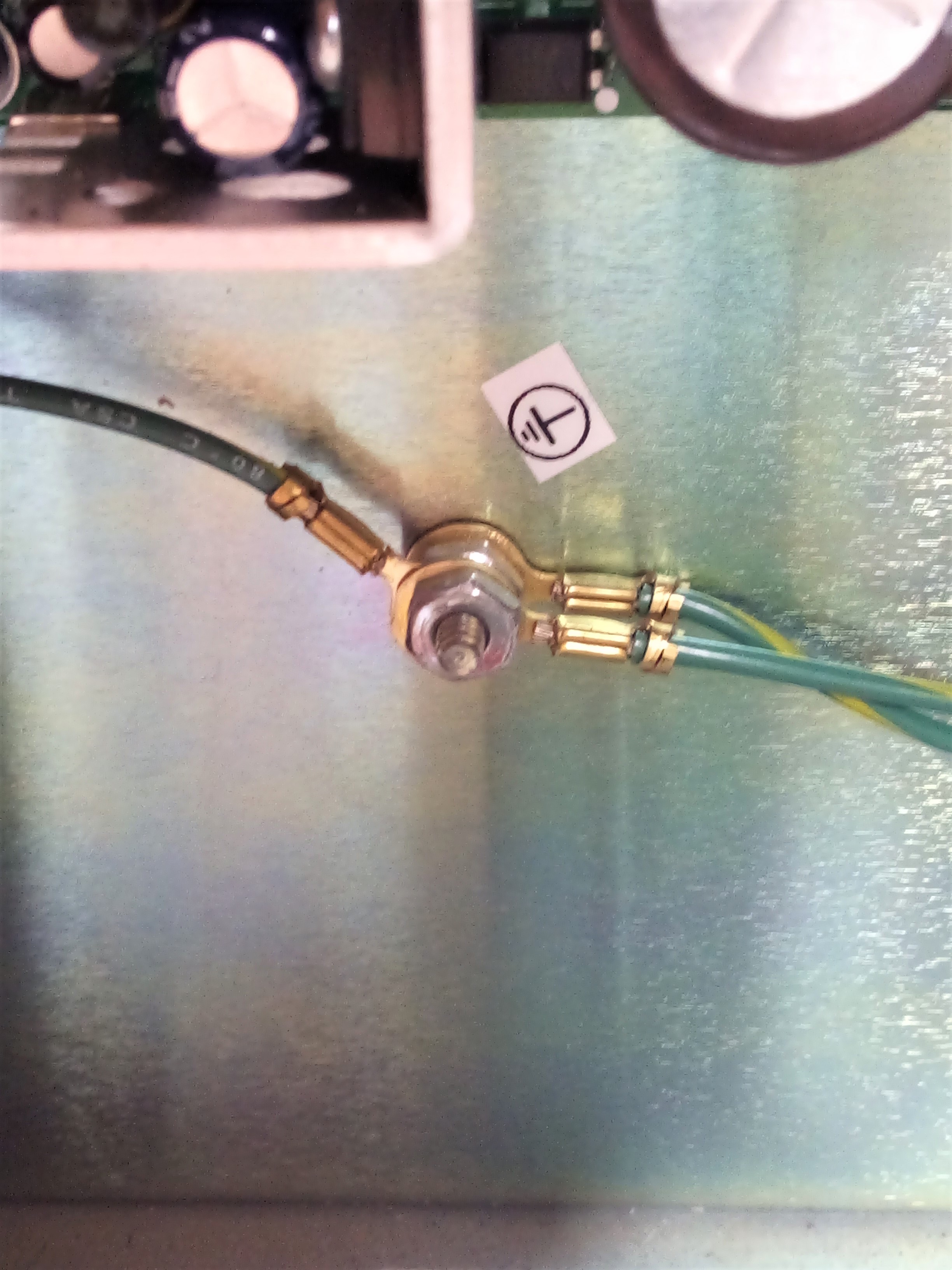

Normally in a facility, each machine or cabinet is connected to ground by a solid screw lug or terminal. This allows each metallic surface to be grounded back to a single connection point.
This is referred to as a ‘star’ configuration.
Now imagine in this facility that another ground wire is spanned between one of the grounded machine frames and one of the grounded control system boards. Since they were both grounded already, this redundancy does not seem like a breach of protocol. However, the previous star configuration now begins to look like a spiderweb, forming separate loops throughout the ground network.
A ground loop can be harmful to signal quality because of the way alternating signals travel in a loop. It’s essentially a single-turn transformer capable of inducing voltage on any signal wires nearby. If any section of that ground loop is exposed to interference, it will travel in a loop through the complete circuit with very low resistance, and therefore a relatively high current. This was not an issue when each machine was terminated with a single dead-ending ground wire, only used when an electrical fault completed the circuit.
The issues usually appear here when a new cable is introduced which suddenly causes faulty or unstable signals when none existed before. This usually happens with shielded cables or I/O devices with devoted grounding wires that span between both devices.
As a general rule, if each machine is grounded already, DO NOT connect extra ground wires for redundancy, especially if they run along the cable routes alongside signal wires. If the grounds already exist and are verified, leave them alone and do not add more. However, if a cable is shielded, other considerations need to be made.

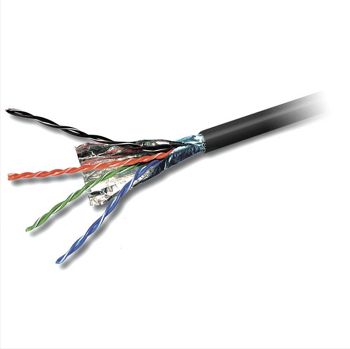

Shielded Cables
Physically, these grounded or shielded cables have a wire mesh or foil wrapping around the wire bundle, just under the insulative jacket. It’s not a single wire passing through along with the others.
Rather, it forms a barrier around the bundle, absorbing and dissipating any electromagnetic interference much like the metal frame of a building absorbing RF signals and blocking cell reception. This is called a Faraday Cage, and a shielded cable is nothing more than a small cage around a set of wires.
If both ends of this shielded wire are connected to pre-grounded equipment, it can cause additional harm by forming the ground loop described above. Sometimes, the recommendation is to connect only one end of the shield conductor, so that it can still absorb interference and pass the signals back to the common ground, but will not create a conductive loop.
shielded cable
Belkin CAT5e Stranded Bulk shielded cable. Image used courtesy of Belkin
However, it is important to note two distinct cases considering shielded cables. If a manufacturer’s specification calls for a shielded cable in an application, it has almost certainly been designed with filter circuits that inhibit ground loop current. The shield conductor has already been attached to the internal chassis ground, and the shielded cable can be installed without concern.
However, when replacing a standard cable (like a serial, USB, or servo drive cable) and using a shielded cable in its place to reduce interference, those filters are not likely to be in place. In these cases, it is recommended to connect only one end of that shielded cable to ground, assuming the devices on each end are already solidly grounded.
