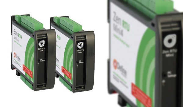

Miniature remote terminal unit (RTU)
Figure 1. Small RTU unit to get data from I/O devices to a SCADA system. Image used courtesy of Define Instruments

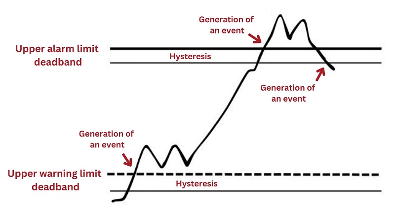

Deadband Processing, or Hysteresis
The deadband processing function is usually employed within control systems to manage events efficiently. The deadband processing in the context of event handling is used to reduce events or alarm generation in the system, hence improving the overall control system performance, particularly in tripping situations where thousands of events/alarms are generated which will overburden the control system.
To eliminate needless multiple alarm generation for values fluctuating around a defined operating limit, each measured value for which operating limits have been defined can be assigned a non-zero deadband known as a hysteresis gap. A limit violation is detected for a measured value as soon as the limit value is crossed. However, to return to normal, the measured value must cross the limit value in the return-to-normal direction by an amount that exceeds the deadband value for that measured value.
After defining the alarm and warning limits for any signal, some specified value defines how large the hysteresis shall be around the warning and alarm limits, as shown in Figure 2. As already described, hysteresis (deadband) reduces the number of events in the system when real values oscillate around the limit. The system event log combines unacknowledged alarms, any audible alarm, any update of the event list, and a print output log.
Alarm limits and hysteresis bands
Figure 2. Upper alarm limit and upper warning limit deadbands

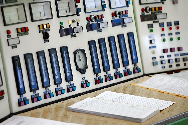

Control panel with meters
Figure 3. Control panels, regardless of generation, should display data logically, with clear alarm and safety limits. Image used courtesy of Adobe Stock
