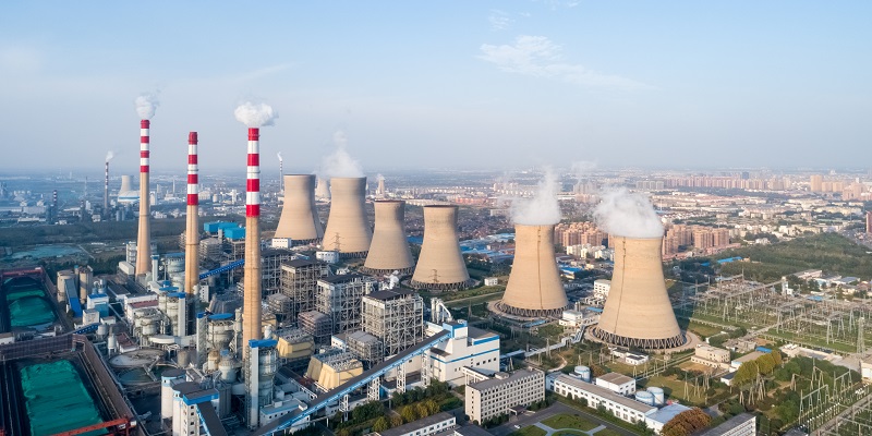

Large power plant
Figure 3. Power plants rely on data acquisition to determine operational output. Image used courtesy of Adobe Stock
