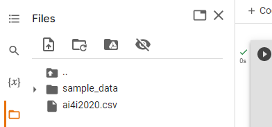

To begin, download the pseudo milling machine dataset used courtesy of S. Matzka from Kaggle.com. This is a CSV file, but in order to use it for the project, it will need to be re-uploaded into the Colab workspace, using the file upload button on the left sidebar as shown below:
Upload file Google Colab

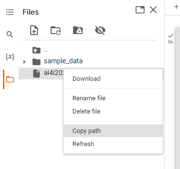

df = pd.read_csv('INSERT FILE PATH WITH FILENAME HERE IN QUOTES')
If you have trouble locating that file path, go back to the sidebar where the file was uploaded and retrieve the path from there.
File path Google Colab

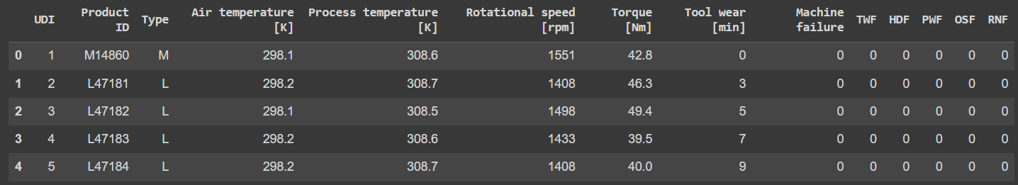

Once loaded, preview the data by chaining the .head() method to the DataFrame object df and execute:
# Display top records of milling data
df.head()
Data file header
Figure 2. DataFrame output. Image provided by author.
The head() method gives us the first 5 rows of the DataFrame. The link to the dataset describes the columns in further detail, but I will summarize some key findings and provide the associated code:

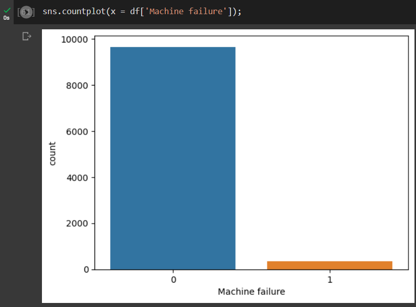

  • The dataset is imbalanced, meaning that the frequency of machine failures is dwarfed by records where the machine did not fail. This can lead to model bias which will be discussed in the model evaluation section. For now, understand that this is a real-world challenge in implementing defect detection in manufacturing. It is also present in other industries, such as fraud detection in finance.
Failure data set
Figure 3. Imbalanced Machine Failure dataset. Image supplied by author

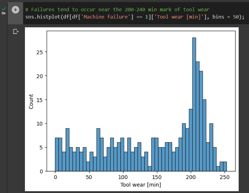

  • As any manufacturing engineer would understand, wear time is likely to correlate to failure. Drilling down within failure records yields an increased frequency in failures with greater wear time clustered around 200 minutes:
Failure frequency distribution
Figure 5. Failure frequency distributed around 200 minutes of tool wear. Image provided by author.

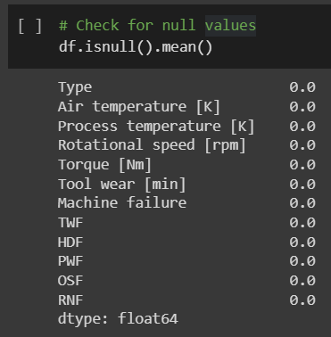

Any null values will need to be imputed or dropped from the DataFrame. In this example, there are no null values in any fields. This is not reflective of the real world, as missing data is common:
Null values per column
Figure 6. Mean of null values per column. Image provided by author.

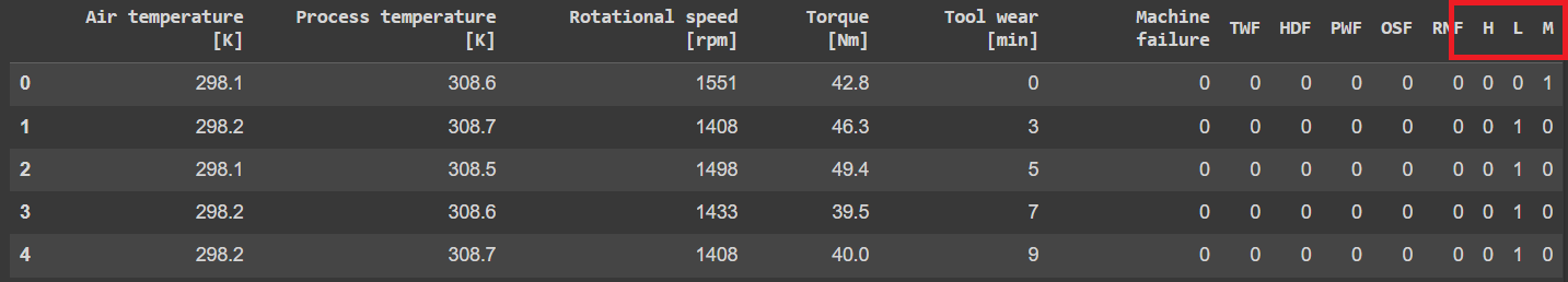

Machine learning models function in terms of numbers. Therefore, categorical string data in the “Type” column must be broken into 3 separate columns of dummy variables (0 or 1s):
# Create dummy variables from type column to dataframe
type_dummies = pd.get_dummies(df['Type'].apply(pd.Series).stack()).sum(level=0)
# Join dummy variables on index of original dataframe
df2 = df.join(other = type_dummies)
df2.drop(columns = ['Type'], inplace = True)
df2.head()
Please note the “L”, “M”, “H” columns on the end, and removal of the “Type” column:
Data column edits
Figure 7. Dummy columns of Type field added to DataFrame. Image provided by author.

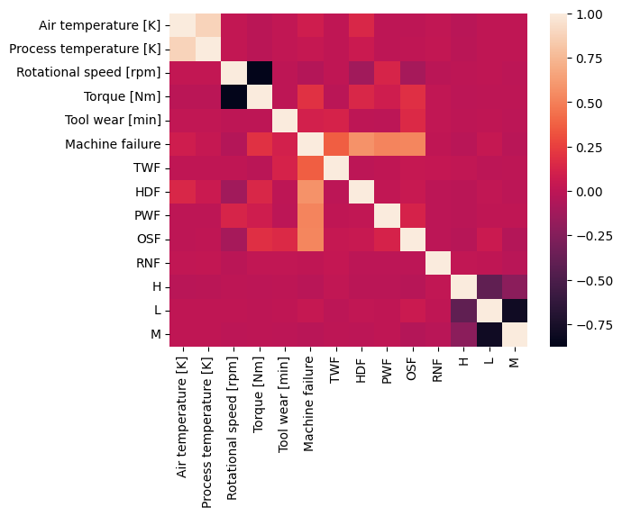

Before beginning the model build and evaluation, a crude check of Pearson correlation can be performed on the attributes of the DataFrame. Torque and Tool wear appear to be correlated to the Machine failure target most closely:
# High correlation of failure to torque and tool wear
sns.heatmap(df2.corr());
Pearson heat map
Figure 8. Pearson’s correlation heatmap of attribute to attribute in DataFrame. Image provided by author.
