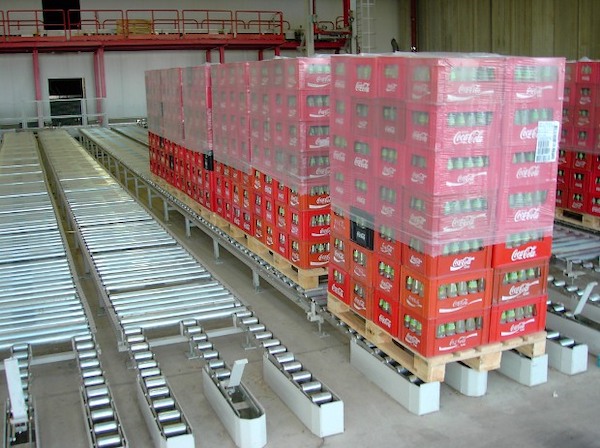

Finally, one more significant difference between these two systems is the type of triggering actions. In a general sense, the ERP is oriented toward economics and finances; therefore, financial transactions trigger actions in the system, whereas actions in an MES solution are initiated by events anticipated as part of the production process.
Figure 1. The MES creates pallet units, and the ERP handles the financial aspects of that pallet as it moves through the distribution chain. Image used courtesy of Saar Lagertechnik
Finances are not relevant in an MES, except for modules reporting consumptions, scrapping, and finished goods creation to the ERP. In these cases, however, monetary amounts are typically not handled by an MES. Rather, it is handled by different predetermined units of consumption or creation: pallets, cases, boxes, etc.

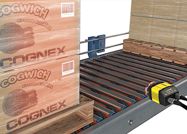

Despite this high level of data consolidation (and perhaps due to the type of business processes involved), virtually all information is manually inputted into the ERP. People must type the information into different ERP interfaces or transactions, depending on the specific process or department.
Figure 3. Pallet barcode scanners can be integrated into a control system that automatically feeds pallet data to the MES. Image used courtesy of COGNEX
While this is another working principle of an ERP, it is a disadvantage in applications requiring near real-time information, such as the manufacturing process itself. This is where the MES enters the equation.

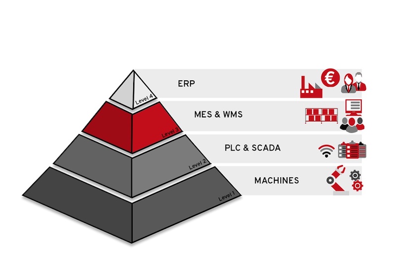

Can ERP and MES be Used Together?
The answer is a definitive yes, and many modern highly-automated manufacturing systems expect to use both.
The main reason for this is the increasingly larger amounts of data generated by the control systems and the need to have near real-time access to that data. Most major MES brands in the market are specialized in communicating with PLC-controlled systems. When designing a manufacturing system with this level of control and automation, the ERP is considered the highest-level system, and the MES is an application one layer below.
Figure 4. The ISA 95 framework defines the different levels at which the ERP and MES are integrated into a control system. Image used courtesy of Objective
