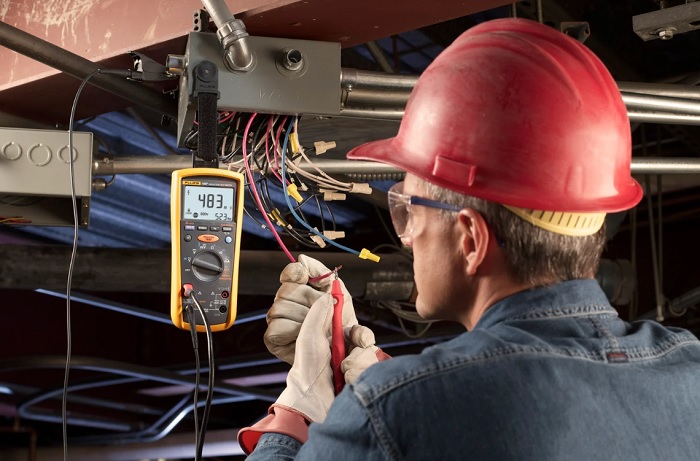

Electrician using a megaohmmeter (megger)
Figure 1. Operator performing a megohmmeter test on equipment for insulation troubleshooting. Image used courtesy of Fluke

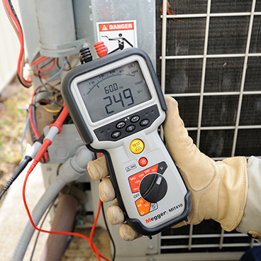

A handheld digital megaohmmeter
Figure 2. Example of handheld megger design in operation. Image used courtesy of Megger

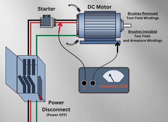

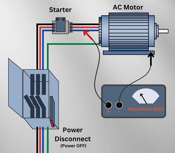

  • Connect the Megger: Connect the megger’s leads to the motor input terminals. The positive lead is connected to the motor's winding, while the negative lead is connected to the motor's frame or ground. This configuration allows the megger to measure the insulation resistance from the winding to the ground. Figures 3 and 4 diagrammatically demonstrate the proper layout for a megger test for both an AC and DC motor, respectively.
Connecting a megger to a 3-phase AC motor
Figure 3. Typical megger testing layout of AC Motor and associated starting equipment. Image used courtesy of the Control Automation engineering team
Connecting a megger to a DC motor
Figure 4. Typical megger testing layout of DC motor. Image used courtesy of the Control Automation engineering team
