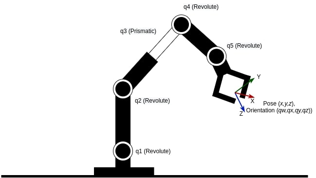

Configuration Space for Manipulators
The configuration space of a manipulator is the collection of all the possible combinations of the positions of joints, revolute, or prismatic that the robot can achieve. A lot of the is impossible for the robot to achieve and is called due to self-collision (the robot collides with itself) or collision with the world elements while the free space is called .
It is essentially a vector of the positions of the joints = [q1, q2, q3, q4, q5]. The task space for the manipulator end-effector is the collection of 3D Cartesian poses (position and orientation)
Figure 2. Robot Manipulator Cspace and task space

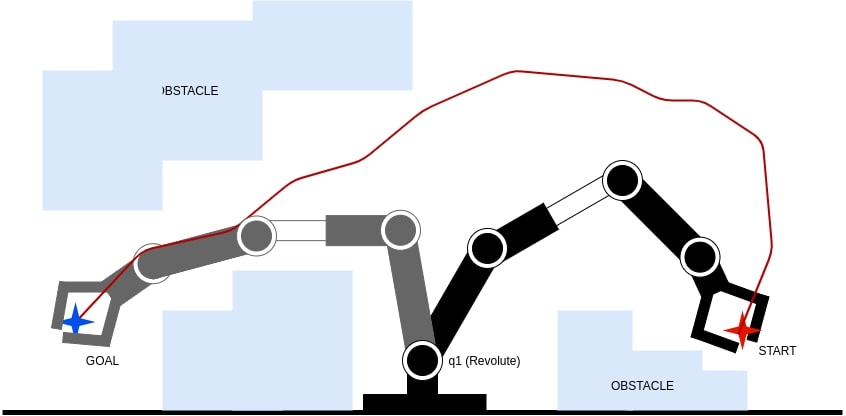

Motion Planning for Manipulators
The motion planning problem for manipulators can be formulated as finding a continuous path for or in task space.
Figure 3. Robot Manipulator Motion Planning Visualization
As mentioned above regarding the motion planning paradigms, planning for manipulators can be done in discrete space (by representing the task space as a set of connected graph points where points are centers of grids from cellular decomposition) or in the continuous space where the complete task space is used to find the solution by searching for a feasible path through it.

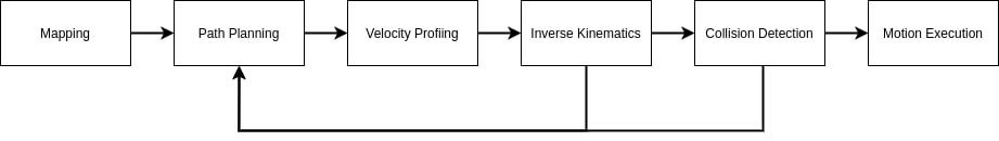

Motion Planning Pipeline for Manipulators
The motion planning pipeline involves elements from the robot environment, the robot’s own motion strategy, and the computational aspects of processing all the required algorithms. The pipeline can be seen below in Figure 4.
Figure 4. The motion planning pipeline elements
The most important nuances of obtaining motion planning solutions for manipulators (considering the solution in task space) includes:
  1. Environmental mapping
  2. Planning
  3. Velocity profiling
  4. Inverse kinematics
  5. Collision Detection
  6. Motion Execution

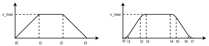

Velocity Profiling
Motion profiles define the variation of the velocity of a point (here the manipulator end-effector), between any two points. After  a path is obtained, motion profiles decide how the end-effector should move while satisfying all the boundary conditions and trajectory requirements along with ensuring smooth motion.
The most common velocity profile used is the trapezoidal profile, easy to program but has a lot of instantaneous acceleration changes and impulsive jerks — not the smoothest for highly dynamic robots. The S-curve profile is a smoother profile that accelerates and decelerates the robot gradually when waking up from rest, thus ensuring smoother motion.
Figure 5. Trapezoidal Profile vs S-Curve

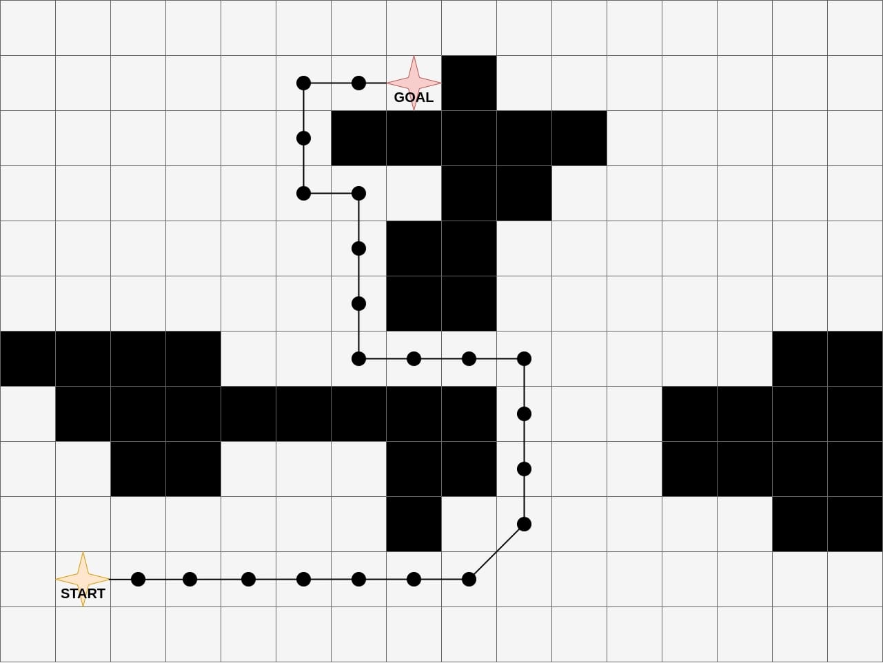

Search-based algorithms are employed in discrete environments where paths are derived from a connected graph that has a path from the start to the target point. Common search-based algorithms are usually graph-search algorithms like breadth-first search (BFS), depth-first search (DFS), A* and Dijkstra. BFS and DFS are uninformed searches ignorant to the cost of traversing the different edges of the graph, usually very inefficient, and not practically deployable in large-scale applications.
A* and Dijkstra’s algorithms are greedy searches that use an immediate reward and a heuristic to compute the best next position to go to. A heuristic is the best “guesstimate” of the cost to move from the current node to the target. An admissible heuristic ensures that the predicted cost is always less than or equal to the actual cost and helps drive the search correctly (only for A* search). While the Dijkstra’s algorithm only uses the greediest next step, A* uses the next cost as well as the heuristic.
Figure 6. A* pathfinding algorithm

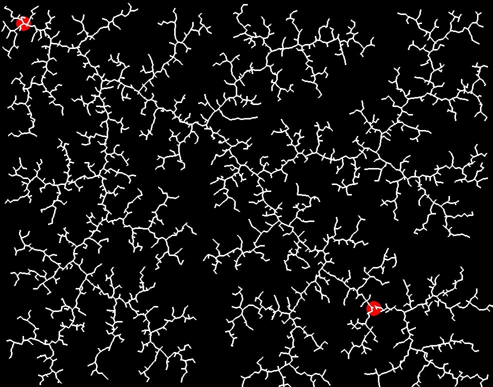

Rapidly-exploring random trees (RRT) and probabilistic roadmaps (PRM) are the most common sampling-based algorithms that randomly extract path points from the continuous 3D coordinates and derive a path through it. RRT*, RRTConnect, and bidirectional RRT are enhancements to the original RRT algorithm used due to improved run-time performance and path continuity.
Figure 7. RRT Algorithm
