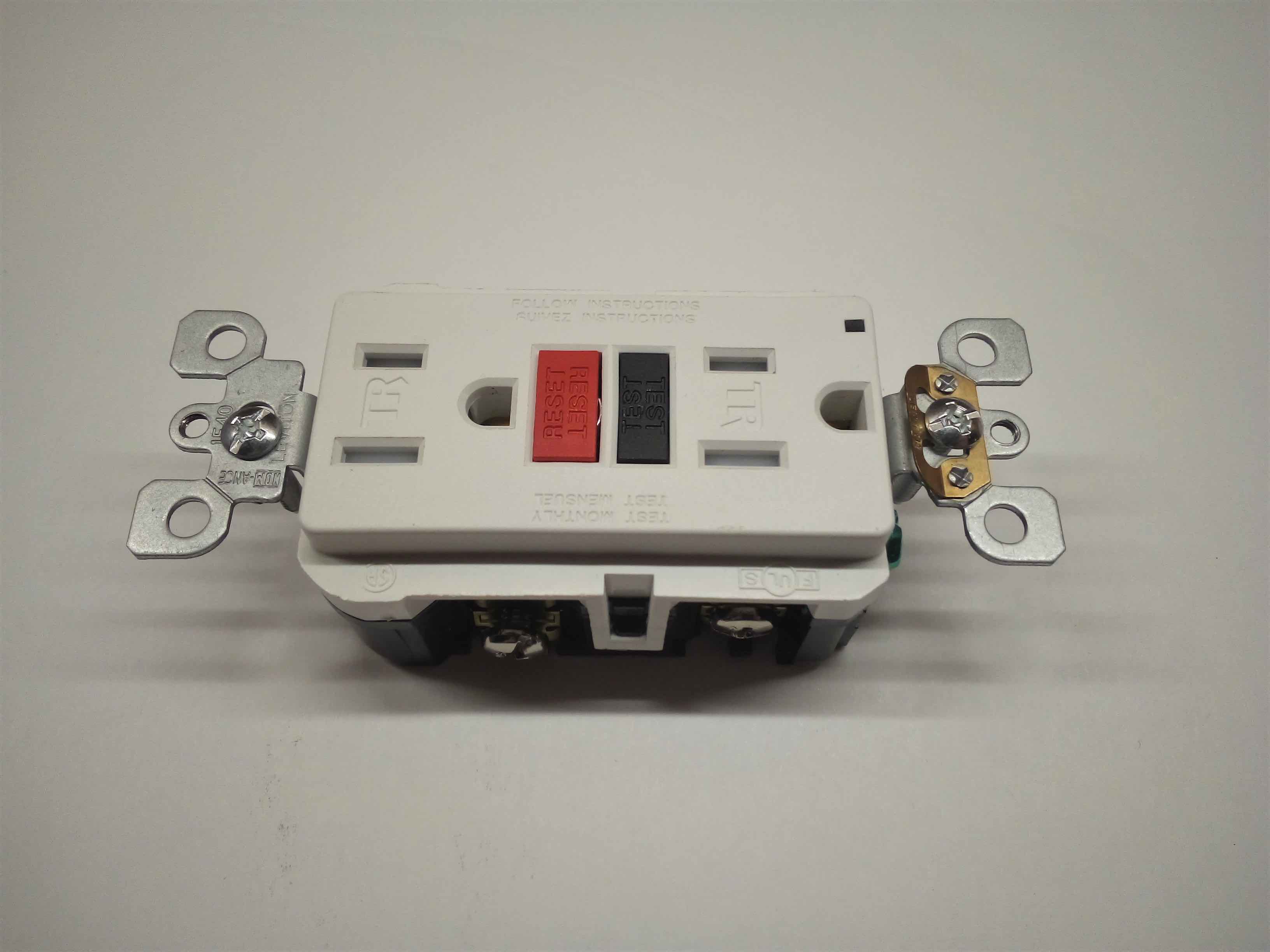

A typical Ground Fault Interrupter receptacle. When energized, the LED on the front will show green.

A GFCI outlet must be installed properly, with a certain set of its terminals connected directly to the hot, neutral, and ground from the supply. When the circuit is active, this connection powers a set of circuitry inside the outlet and indicates function with the green LED. If power is not applied, the circuitry cannot function. So, on these outlets, you cannot press the test or reset button until power is connected.

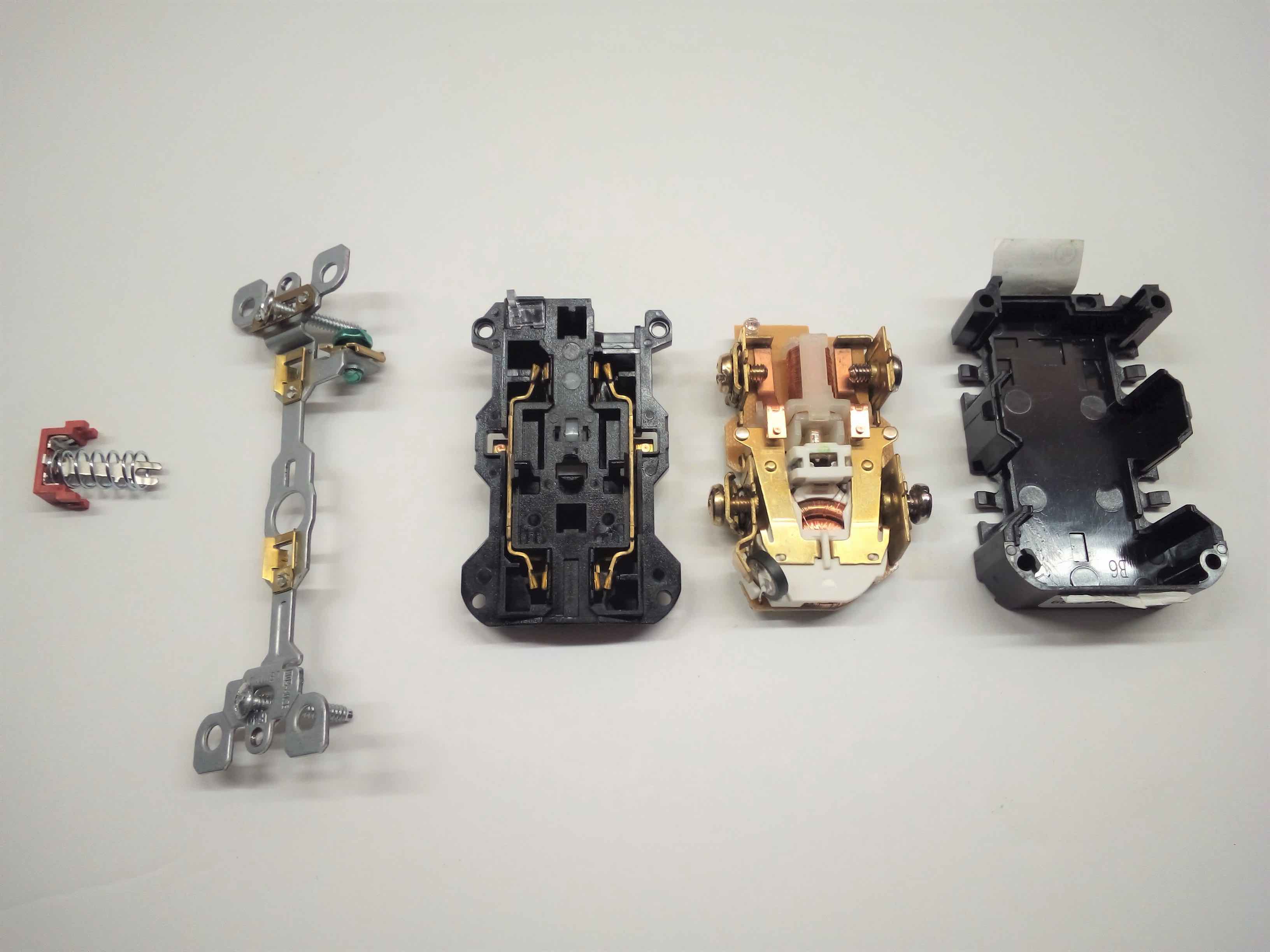

A disassembled GFCI receptacle. From left to right: the ‘Test’ button and spring, grounding chassis, upper container, sensing and disconnecting circuits, and the lower chassis.
Inside the outlet, two small inductive coils measure very precisely the current traveling through the hot wire and the neutral wire. These numbers should be equal in all cases. Whether the load is connected to that outlet, or to one downstream, all current supplied through the hot wire should return through neutral.
A close-up view of the internal coils and contacts of the GFCI receptacle. Near the left, the long coil is a solenoid that switches the circuit off. On the right, the two nested sensing coils detect the hot and neutral currents. In the center, contacts switch the circuit on and off, much like realy contacts.
If for any reason, the current supplied by the hot wire exceeds the current in the neutral wire by more than 5mA, it instantly disconnects the circuit with a small solenoid coil. If this excess current is sensed, it would mean that electricity is somehow exiting the circuit and returning via another ground path. If water is present, that return path may be through anything metal nearby.

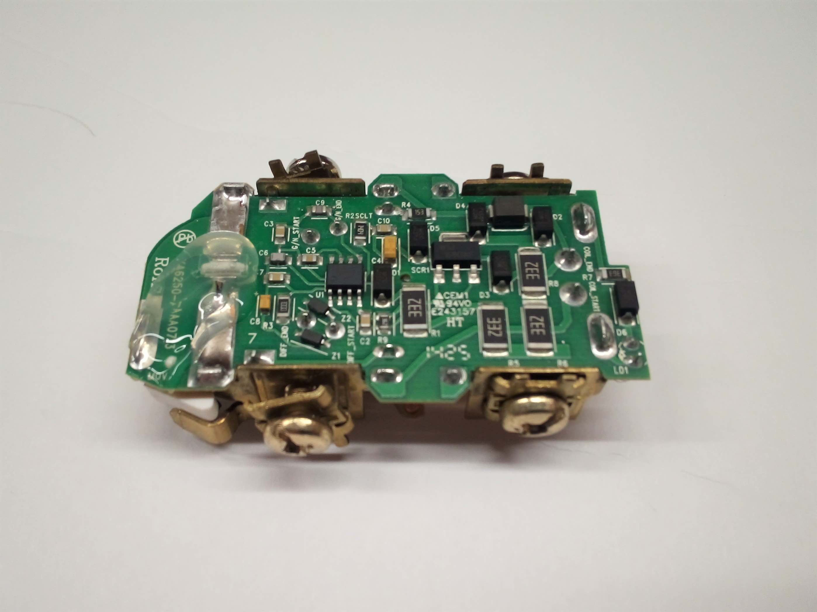

The fairly complex back view of the sensing circuit PCB, contained inside a GFCI receptacle. The circuitry compares the currents of the live and neutral wires.
