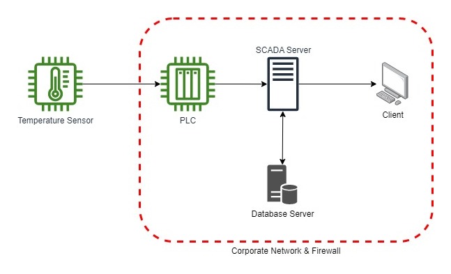

Basic IIoT Architecture for Predictive Maintenance
The adage “easier said than done” applies to IIoT systems. The breadth of technical skills required and collaboration between different teams within a company is challenging. A simple IIoT system is usually composed of the following elements:
Sensors
There are endless possibilities for sensor applications. Some examples are temperature, humidity, and vibration sensors. Sensors can either be analog 4-20 mA signals, digital boolean signals, or even more advanced protocols such as IO-Link.
Edge Device
A computer such as Raspberry Pi, Arduino, or PLC with limited computational power can serve as a gateway to the corporate network. The capabilities of even the simplest modern computers, paired with reducing costs, are rapidly advancing computer modules.
Communication Protocol
Modbus, OPC-UA, and MQTT are examples of protocols used in IIoT to communicate between machines and with edge/cloud gateways.
SCADA / MES Server
Ignition, Open Automation Software, and Adroit Ignite are examples.
Relational Database
A relational database serves as a central collection point for relevant data to be logged, scanned for trends, or shared with other applications. Examples include PostgreSQL, MS SQL Server, and Oracle MySQL.
Basic architecture diagram of an IIoT system used to capture data for preventative maintenance
Figure 3. Basic architecture diagram of an IIoT system used to capture data for preventative maintenance. Image supplied by author
