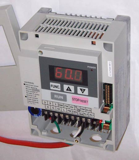

small variable frequency drive
Figure 1. An example of a small variable frequency drive. Image courtesy of C.J. Cowie. [CC BY-SA 3.0]
