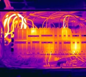

Electrical Panels
As electrical energy passes through any conductor, it generates heat. This is no problem at all. But in cases where the heat is greater than the normal values or ranges, it is a situation that needs to be inspected.
Figure 1. Thermal imaging helps measure heat signatures in electrical panels. Image courtesy of Infrared Imaging Services
Excessive heat could be due to electrical malfunction in the circuit or unwanted resistance. By inspecting the particular electrical component like a circuit breaker or a conductor, one can track the cause of this excessive heat generation. It can be also beneficial for:
  • Making unevenly distributed load to evenly distributed load
  • Finding unbalance phases of power supply
  • Locating and eliminating loose connections and conductors
  • Detecting overrated or underrated electrical components

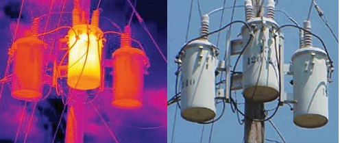

Transformers in Power Systems
A transformer is an important device within power supply systems. Thermal imaging is an effective method for monitoring the transformer’s state.
Figure 2. Checking a transformer’s state can be done using thermal imaging. Image courtesy of Flir.
It is not possible to physically inspect the transformer often due to the challenge of accessing the transformer. So thermal imaging is used to monitor and inspect its condition.
 Thermal imaging is used to inspect the transformer for a variety of possibilities:
  • Cooling system: In transformers, oil is used as a cooling mechanism by circulating in the tubes. Thermal imaging of these tubes helps verify the correct working of the cooling system.
  • High- and low-level voltage connections: The condition of the high- and low-level voltage can be checked for loose or broken connections.
  • Installed electrical components like breakers, fuses, and cables: We can analyze the electrical components associated with the transformer to get a broad overview of its condition.

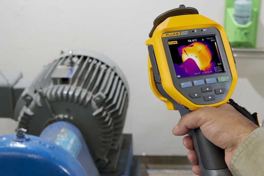

Motor Inspection
The motor is one of the basic parts of any machinery, and the whole operation depends on the normal and satisfactory working of the motor. Therefore, thermal imaging is effectively used for the possible cause of malfunctioning. When inspecting motors, the following must be considered:
  • Motor Housing: All the components within a cover called housing. Any problem in the motor will cause the motor housing to quickly heat up.
  • Cooling Fan: Check the condition of the cooling fan attached at the rear of the motor by making sure that there is no abnormal heat pattern present.
Figure 3. There are a variety of things that thermal imaging can check in a motor. Image courtesy of Fluke
  • Connection Box: Look for any hot points in the connection box. Any unwanted hot surfaces could be a sign of a loose, damaged, corroded, or shorted connection.
  • Attached Shaft: Normal heat pattern in the shaft portion indicates that the bearing is in good condition and is working fine. The coupling must also stay in a satisfactory condition free from any misalignment.

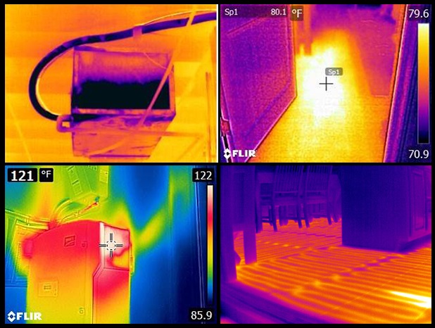

HVAC
HVAC systems create specific environmental conditions for different requirements, for example, product manufacturing or certain room conditions in the health care industry.
Figure 4. Thermal imaging gives a good idea of how an HVAC system is performing. Image courtesy of Flir.
Thermal imaging is used to detect heat loss in HVAC systems due to leakages in ducts or problems with the insulation system. If there is a leakage, then the cooled or warm air will be escaping from the duct. This temperature difference can be detected by a thermal imager, allowing for quick fixes.
It also helps by detecting blockages in a duct system due to mechanical system failure or a foreign body in the duct.
