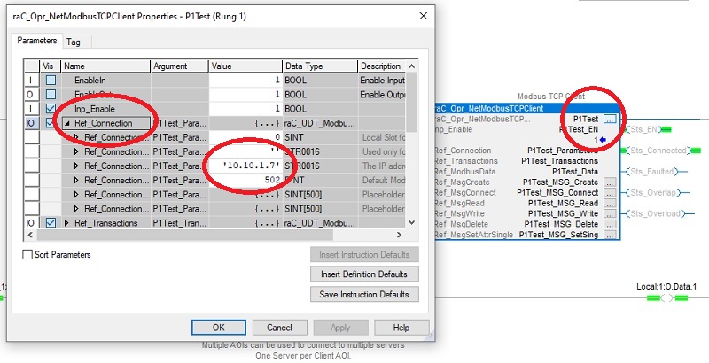

In an Allen Bradley PLC, such as the Compact or ControlLogix series, an Add-On Instruction (AOI) for Modbus is available from Rockwell Automation for Modbus TCP transactions. This must be imported into the code to be used.
When added, this will create a Controller-Scope tag set for the Modbus Client allowing up to 5 function code tasks (called transactions), each of which can be enabled or disabled with a BOOL tag.
First, the IP address of the client is added into the appropriate tag field, shown in the figure below. In this example, no pre-configured device with an EDS was ever added to the project tree, as the entire reason for this project is for those devices which aren’t simply ‘plug and play’ - we don’t always have that luxury.
Modbus address for Rockwell
Figure 2. Modbus address for Rockwell AOI. Author’s image
To elaborate an example, pretend you have a remote I/O terminal with 8 inputs and 8 outputs.
You wouldn't want to energize all 8 outputs all the time, but you would want to monitor all 8 inputs continuously.
From our function code list, this would be function code #2, with a length of 8.
Modbus transaction Rockwell
Figure 3. Rockwell AOI example for reading multiple coils. Author’s image

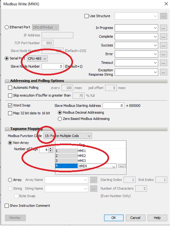

In this example, the Automation Direct Productivity PLC will be used to demonstrate a Modbus RTU communication over an RS-485 serial interface at node 3.
First, the serial communication ports on this PLC allow either RTU or ASCII - this should be an inherent requirement if you wish to communicate across one of those channels. Figure 4. Illustrates the hardware configuration for choosing RTU or ASCII on either the RS-485 or RS-232 ports.
Modbus port config
Figure 4. Hardware configuration for Modbus on RS-232 and RS-485. Author’s image
Once the port is configured, many Modbus devices can be connected.
In this example, a set of the first four consecutive output terminals on a remote I/O block are to be controlled from an HMI screen at the central control station. Those HMI tags are HMI1, 2, 3, and 4, respectively.
Modbus transaction
Figure 5. Node address, function code, and source tags can be seen in this Automation Direct example. Author’s image
If those terminals are perhaps not the first four, but are still consecutive, simply adjust the starting address.
If the terminals are not consecutive, multiple transactions must be used.
