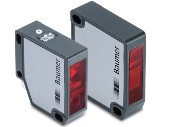

Appropriate use of laser sensors in the scenario described previously is to use two sensors, either pointed in opposing directions on the T-cart or from opposite ends of the track if they will be mounted off the T-cart’s body. This setup provides redundancy to the system, and the PLC receives enough information to detect many different faults within the system.
Figure 4. A laser distance sensor. Image used courtesy of Baumer
With two lasers, the PLC or control unit will receive two separate data feeds. These data feeds should theoretically be within a certain range of each other. If the data received goes outside the given range, the PLC recognizes something has happened within the cell. Either something has fallen in the path of the T-cart, or the laser is giving faulty information.
A system involving two lasers also has the added benefit of checking any sporadic data from the sensors. If one sensor “jumps” in its location, but the other does not, the PLC can be programmed to send an alarm to the system.
