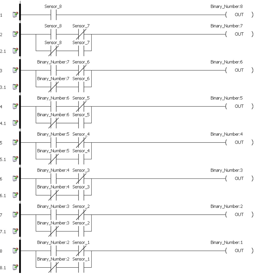

Although it does not match standard binary, the Gray-code-to-binary calculation can be done quite simply, and here are some examples in standard ladder logic, and in structured text using C++.
Ladder Logic Conversion
To convert the Gray code bits into the proper binary bits, each Gray code sensor must correspond to a Boolean value, either directly from the sensor, or as part of an integer.
This example is written in a ladder programming software from Automation Direct and assumes that ‘Sensor_1’ is the Least Significant bit (LSB), the sensor along to the outside edge of the encoder disk. There are eight total sensors (8-bit) increasing into the center of the encoder.
‘Binary_Number:1’ is the corresponding bit of an integer used to store the standard binary equivalent. For other software, such as Rockwell’s RSLogix, this integer bit might look like Binary_Number.0 where Binary_Number is an INT type tag, starting at bit 0.
- Line 1 - For proper conversion, the most significant bit (MSB) which is Sensor_8, remains the same.
- Line 2 - For the next significant bit, a logical comparison of ‘Exclusive OR’ is used between Sensor_8 and Sensor_7. This will return a 0 if Sensor_7 and _8 are both the same, and will return a 1 is Sensor_7 and _8 are different.
- Line 3 to 8 - For every remaining bit, we continue to use an ‘Exclusive OR’ between the previous bit and the next Sensor value.
If the encoder is 10-bit, there will be 10 lines, and the first two lines will use Sensor_10 and _9 and descend until the last sensor is finally used.
Figure 1. An example of ladder logic used in a ladder programming software from Automation Direct.
All of the preceding logic lines may be wrapped into a single custom instruction block or subroutine to simplify the process.
