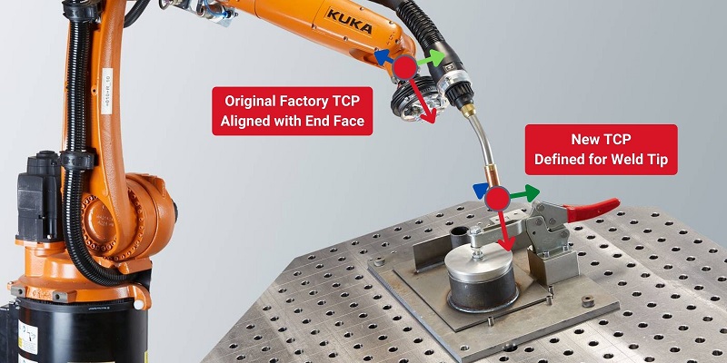

Robot TCP example
Figure 1. A representation of tool center point (TCP) differences between the factory-supplied default position and the custom TCP for a user’s welding tool.

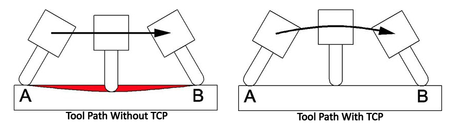

Figure 2. A diagram showing tool path with and without a TCP. In the left image, the flat motion and rotation of the mounting plate causes the tool end to travel in an arc. In the right image, the properly defined TCP causes the arm to compensate for the arc of the tool end. Image courtesy of FANUC.
