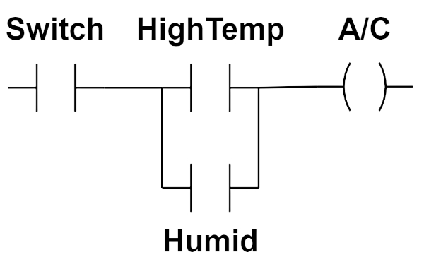

Take, as a basic example, the single rung shown in figure 2. Notice that the A/C (air conditioning) is only active when the Switch is active, and either HighTemp or Humid is active.
Figure 2. Ladder logic rung for controlling an A/C system. Information used courtesy of Wikipedia
Expressed as a rule, this rung would take the following form:
A/C = Switch AND (HighTemp OR Humid)
Because ladder logic can be expressed as rules, it readily lends itself to adoption into fuzzy logic control. Another way to think of this is that the outcome depends on the IF conditions represented by the ladder logic symbols to the left while the output represents the THEN result.
IF (Switch AND [HighTemp OR Humid]) THEN A/C

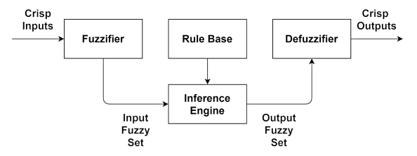

Figure 3. Block diagram representing a fuzzy logic system.
This approach can certainly be implemented using fuzzy logic rules. In such a case, the crisp inputs would be temperature and relative humidity. Sensor reading of these values would be transformed into fuzzy inputs by a fuzzifier. The inference engine would contain, among other rules, the one shown above. Based on the rules of the inference engine, a fuzzy output set would be presented to the defuzzifier. From there, crisp outputs would be provided to the control system.

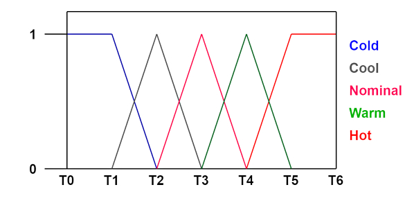

The first step in designing an FLC is identifying the input, output, and state variables involved. Next, determine the fuzzy subsets for the variables. For example, temperature input may be divided into five subsets with a descriptive linguistic label for each: {‘cold,’ ’cool,’ ‘nominal,’ ’warm,’ ’hot’}.
Figure 5. Example of using membership functions to represent temperature.
Once the subsets have been chosen for the variables, membership functions should be configured to represent these subsets. Options for membership functions include triangular, trapezoidal, sigmoid, and Gaussian. This constitutes the fuzzifier that converts the crisp inputs into fuzzy values. Note that fuzzy subsets and associated membership functions also need to be configured for the output of the inference engine.

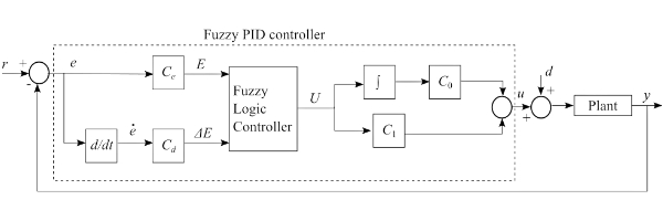

Similar applications that benefit from FLC include curing rubber or drying solvents on painted surfaces. In addition, all of these are examples of control processes that typically utilize a PID (proportional integral derivative) controller. CNC (computer numeric control) machining often depends on fuzzy logic controllers, as do many autonomous robotics, machine vision, and remote sensing.
Figure 6. Block diagram for a Fuzzy PID controller. Image used courtesy of Mathworks
