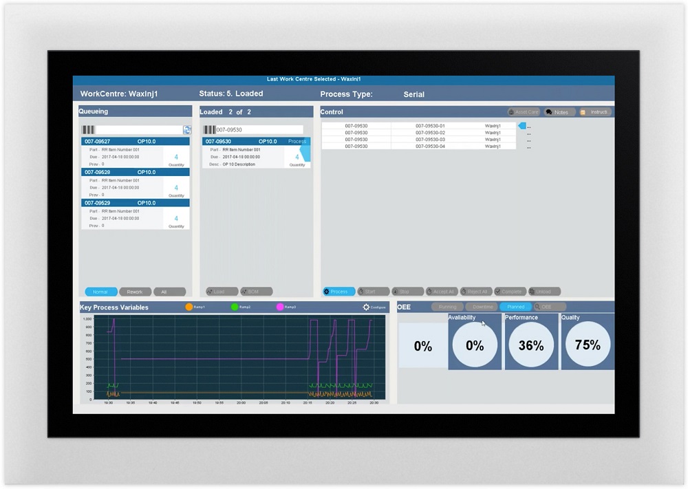

As the name implies, a human-machine interface is a medium that allows operators, technicians, and supervisors to monitor and control industrial systems. This can include extensive monitoring dashboards for manufacturing areas in a plant down to the granular level of an interface used to control a plant asset such as an automated assembly machine.
Example HMI display
Figure 1. An example of an HMI screen. Image used courtesy of Inductive Automation

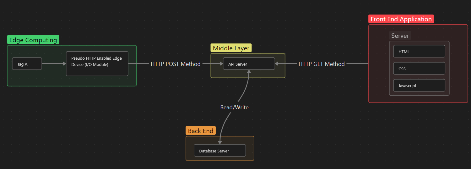

In this article series, we will explore a simplified web-based HMI solution. The solution will comprise the below elements:
Web based HMI system architecture
Figure 2. Solution architecture for a simple web-based HMI. Image provided by the author
The technology stack includes:
  • Edge computing layer
  • Data middle layer (API Server)
  • Back end database layer
  • Front end web application layer

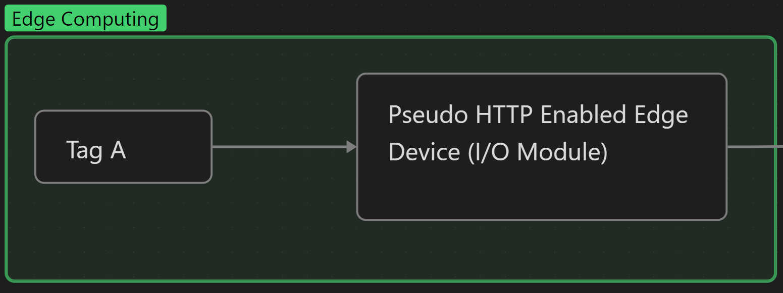

Edge Computing Layer
The beginning of a web-based HMI solution originates at the plant floor level. The hardware and gateway device are critical steps in the process. For this walkthrough, I assume there is a single read-only tag, Tag A, for simplicity. This tag is connected to an I/O module or gateway device capable of HTTP communication. One such example of a device is the Groov EPIC by Opto22, or industrial PCs capable of HTTP communication. Some PLCs also have this ability built in or enabled by add-on solutions.
Figure 3. Edge computing layer. Image provided by the author
In order to communicate and facilitate data transfer outside of the local machine network, the HTTP-enabled edge device will need to send an HTTP POST request containing a body of data. A programmatic example can be given with the example below using the Python requests library. The function of this code is to send a sample tag with data every 5 seconds to an API server. Comments denoted with the # character explain the process steps:

In order for this script and protocol to function, we have to send the POST request somewhere in order for data transfer to occur. This “somewhere” entity is an API server in the middle layer of our solution. At this point in the project, the API server is not defined and we presently have no way to transfer our payload of Tag A data outside of the local machine network on the plant floor.
Our next steps continue in Part 2 of this series.
