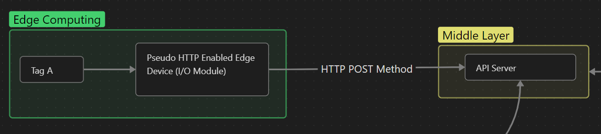

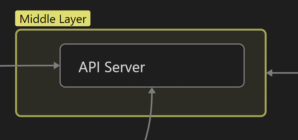

In practice, these middle layers are typically implemented as an API or application programming interface running on a connected server device, which may be as simple as a small single-board computer, or a large industrial server. In our HMI architecture, the middle layer resembles below:
Middle layer for HMI development
Figure 1. The middle layer for the HMI application. Image provided by the author

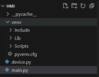

Within the same project directory or folder location within the file explorer of your PC, create a new file named “main.py”. Using an IDE such as VS code will make this process seamless. A virtual environment (venv) is a best practice but is not required, and out of scope for this article.
Project file directory
Figure 2. File directory. Image provided by the author

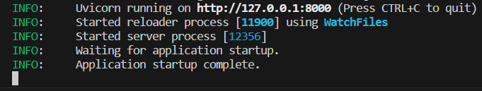

Now we can run the server that will host our API. The server in this case will be localhost using the Uvicorn implementation. FastAPI is built on top of Uvicorn, and when we used the “[all]” extra requirement specifier in the pip install earlier, Uvicorn was installed as a dependency. To start the server enter the following in the command line. If you named your file other than main.py the “main” argument below should be replaced with your respective module name:
uvicorn main:app -–reload
The reload flag allows the server to automatically reload if you make changes to the main.py code and save. This saves time from having to manually stop and start the server again. If the startup is successful, the below should show:
Startup success
Note the first line, “Uvicorn running on...”. That URI is the API server that we will append the “/tags” endpoint to in our device.py script in gray bold below:

We have successfully created a bridge between our device and the API server for the device to push data to the server. Systematically, this looks like below:
Currently completed system
Figure 3. Solution architecture now completed at end of part 2. Image provided by the author
