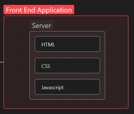

What is a Front-end Application Layer?
The front-end application layer in software development refers to the user-facing side of the application. The user interface is a key facet of the front end, allowing the user to visually see the structure of components and features as well as interact with these components. The front end also serves to present data from back-end services, such as the API server created in Part 2. Some of the main technologies used in the traditional technology stack include:
  1. HTML - Hyper Text Markup Language is a tag-based language that outlines the structure of a web page and where components should appear. The latest version is HTML5 which offers enhancements such as the canvas element for dynamic visuals. HTML5 is the latest incarnation of core HTML.
  2. CSS - Cascading Style Sheets are what make a website look more visually appealing with colors, fonts, layouts, and spacing.
  3. Javascript - Javascript handles any dynamic content within the webpage. In this example, Javascript will be used to generate a dynamic table of Tag A values within the webpage HMI.
Front end application
Figure 1. The front-end layer for the HMI application. Image provided by the author

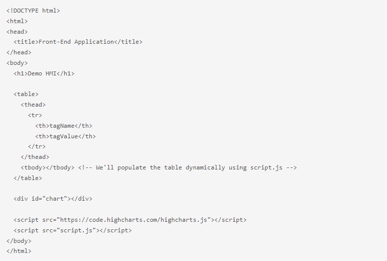

Next, we will populate this HTML file with the HTML tags that define the structure of the page. We will also define a script element, denoted by tags, that utilizes Javascript to send HTTP GET requests to the GET resource we have defined on the API server:
HTML code for displaying data

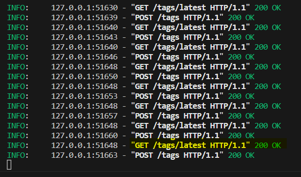

Well, that doesn’t look right. Where is the table data?! Let’s check our main.py API server logs for some more information:
GET/POST status codes
Figure 5. Status code from GET request. Image provided by the author
Now this really doesn’t make sense! How is our API server indicating that GET requests have been successfully sent to our HMI application, yet no data is populating the dynamic table in the application?
