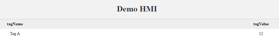

Formatting the HMI With CSS

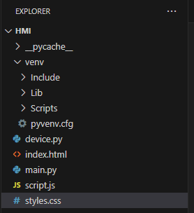

Note that the format of the HMI application does not look professional. The operators and technicians of this HMI would likely have pointed feedback regarding the UI. Let us format the structure in a more visually appealing manner using CSS. We will create a new file in the root directory called styles.css:
styles css in the root directory
Figure 3. Styles.css in the root project directory. Image provided by the author
Within that file, we will enter the following:
body {
    background-color: #f2f2f2;
  h1 {
    color: #333;
    text-align: center;
    margin-top: 20px;
  table {
    width: 100%;
    margin: 20px auto;
    background-color: #fff;
    border-collapse: collapse;
    border: 1px solid #ccc;
  table th,
  table td {
    padding: 10px;
    text-align: center;
  table thead {
    background-color: #eee;
The result appears below:
Better format for web HMI
Figure 4. CSS applied to the front-end HMI. Image provided by the author

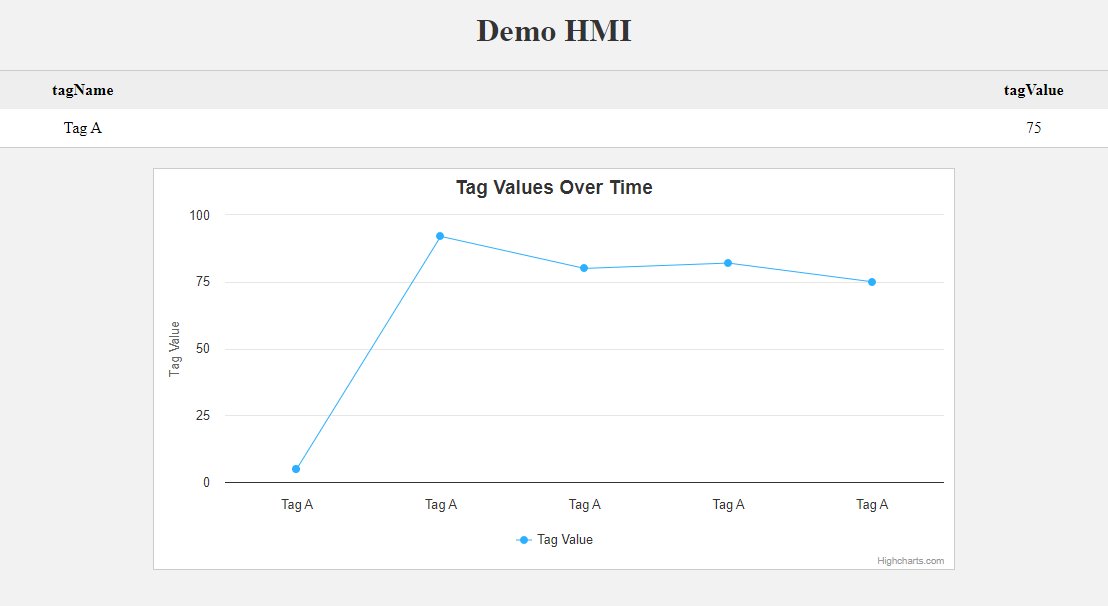

Historian Capability
The last step in our initial demo HMI front-end user interface is to show some rough visual of the Tag A value over time. To accomplish this, we can use the highcharts package in Javascript. Please make the following updates to the script.js file below:
// Create an empty array to store the historical data
var historicalData = [];

Lastly, we will add some styling to the highchart in the styles.css file. Please make the following changes below:
body {
  h1 {
    color: #333;
    text-align: center;
    margin-top: 20px;
  table {
    width: 100%;
    margin: 20px auto;
  table th,
  table td {
    padding: 10px;
    text-align: center;
  table thead {
  #chart {
    width: 100%;
    max-width: 800px;
    margin: 0 auto;
When all is put together, the HMI should appear similar to below:
Web HMI with historian graphFigure 5. Front-end result of a rough HMI end-to-end project. Image provided by the author
