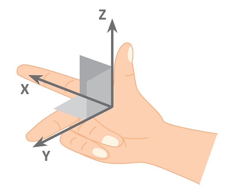

An effective method to remember frames involves utilizing the "right-hand rule," which offers a straightforward approach to understanding coordinate systems by referencing your right hand for clarity.
The right hand rule robotics
Figure 1. The “right-hand rule” is used to recognize the orientation of coordinates easily. Image (modified) used courtesy of Adobe Stock

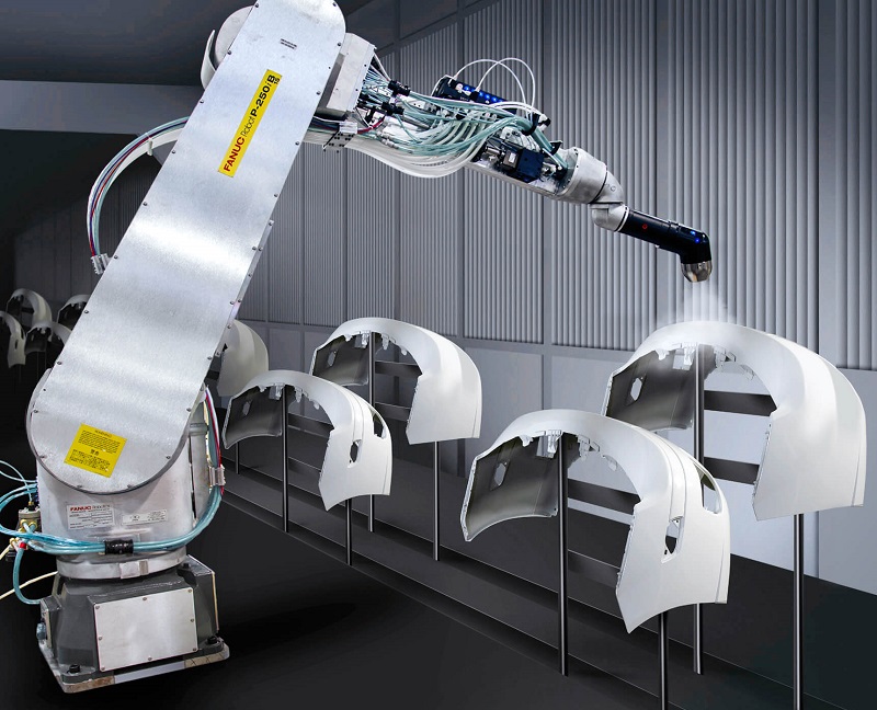

FANUC painting robot
Figure 2. By establishing a user frame along the car part, the robot will automatically track a curve along the top. Image used courtesy of FANUC

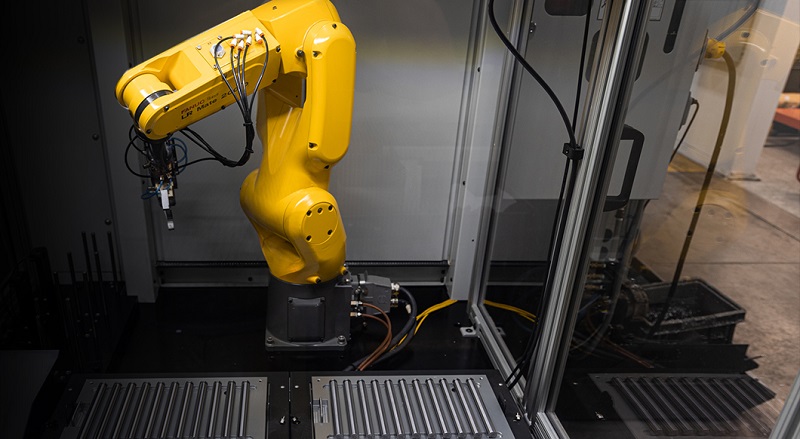

A robot work cell
Figure 3. User frames within this application would reduce the position registers needed in half. Image used courtesy of JTM Engineering
