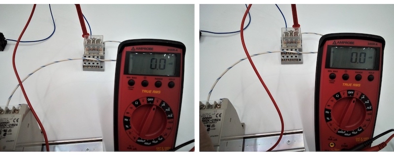

Similar but opposite measurements will indicate a power-side switched circuit. When the load is de-energized, all voltage is lost on the control devices before reaching the load. Therefore, both terminals of the load should measure 0.0 volts, as shown in Figure 2 below.
Power side switching circuit measuring 0 volts on both load terminals when de-energized
Figure 2. With the load de-energized, a power switched circuit will show both terminals measuring 0.0 volts.
