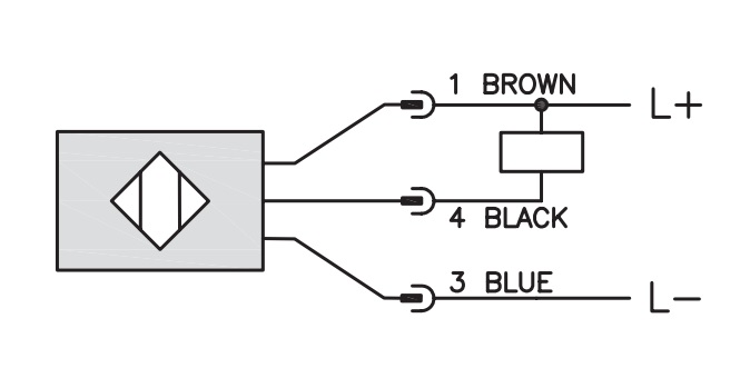

diagram
The wiring diagram for a typical NPN sensor. The load rectangle symbol connected to +V indicates a sourcing input module, requiring a sinking (NPN) sensor.

Wiring Diagrams of NPN Sensors
The input module’s common voltage may be identified by observing the common wire or by measuring the voltage at each input terminal. However, identifying the sensor’s polarity by simple observation can sometimes be more difficult.
In a separate article discussing PNP sensors, several representative device diagrams were shown to have a +V, -V as well as a Load wire. This load wire was attached to the rectangular symbol of a load device, which commonly would be the PLC input terminal. The opposite side of this load rectangle will connect either to power or to ground.
In the diagram of the NPN sensor, the load device will be shown to be connected directly to the +V source.
This connection represents the common voltage wire of the input module, which is also connected to the +V source. When the sensor is energized, the input module is the +V connection, and the sensor is the -V connection, completing the circuit.
The current can flow through the completed circuit and the input module detects the energizing of the sensor.
