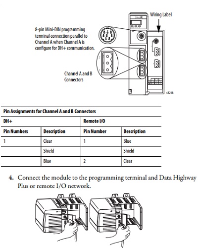

The first is the wiring simplicity. The DH+ system has only three wires - Blue, Clear, and Drain - making it very easy to work with, able to be serviced with basic tools, and with keyed removable connectors, has some natural immunity to getting wires crossed up or reversed.
DHRIO module wiring
Figure 1. DHRIO module wiring information. Image used courtesy of Rockwell

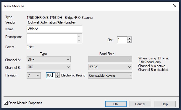

DHRIO software setup
Figure 3. Adding a DHRIO module into a Studio 5000 project tree. Author’s image

One of the benefits mentioned throughout is the simplicity of DH+. This simplicity is also noted in how DH+ networks are set up on the software side. Most people have painstakingly added device after device into RSLinx. When working with the 1756-DHRIO module, there’s no need for this! Wire up your DH+ network, set the node number and baud rate with the DIP switches, and add the card to your rack. Then you just set the appropriate channel to DH+.

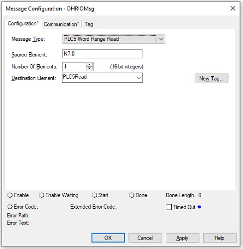

Figure 4. Message configuration defines the origin PLC type, along with the requested address (Source Element), the number of integers to be delivered, and the tag name of the destination. Author’s image
After doing this, you can go into that chassis in RSLinx. You will see the card, see the DH+ channel inside of it, and it will automatically populate all the devices in that network to go online with them!
Finally, I want to cover some considerations that must be made when deploying a system that exchanges data with a ControlLogix system. ControlLogix communicates over DH+ readily with a MSG (message) instruction within the ladder logic.
It might be tempting to simply exchange a couple of arrays of BOOLs or INTs to send data back and forth, but this can easily bog down your network. A good way to alleviate this problem is to tie a timer into your MSG instruction trigger that you can adjust at will as you add data exchanges. Another good idea is to limit your exchanges to only what is needed at the time. This may be more labor-intensive to change your tags every time you want to add data, but if you are running dangerously low on speed, it is a good tool to know about.
