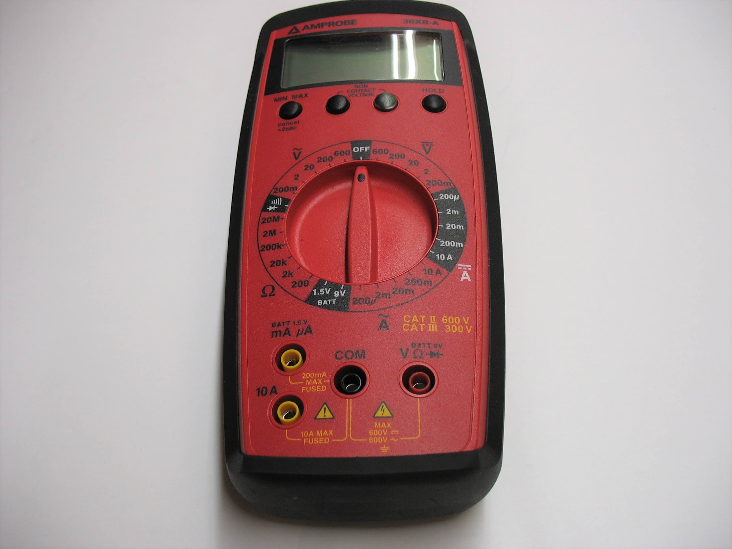

Reading a simple constant voltage from most digital multimeters is extremely simple - turn the dial to the DC voltage icon and place the test leads at two exposed circuit contact points, and a number appears. But this simple reading is only the very surface level of a function that is designed to be much more capable than a single reading.
On some meters, especially the older style of analog multimeter, most of the readings must be selected to read at the proper range. If you want to measure a specific voltage, you must select the appropriate value range. These are called ‘manually ranging’ meters in contrast to the common auto-ranging type.
Manual Range Selection
You must first determine what voltage you expect to measure, or at least close. If you have an industrial control system in front of you, 24 volts is the likely measurement. A small computer board might be more likely at 3.3-5 volts.
Whatever that target voltage happens to be, select the range with a value just above that number. Sometimes, the ranges might include: 1, 10, 100, and 1000 volts, or perhaps 2, 20, 200, and 2000 volts. In this scenario of testing a 24-volt system you must choose the 100 or 200-volt range, respectively.
If the range selection is too small in value, the meter will read ‘OL’ which means ‘Over Limit’. Some people say Over Load, which is an accurate description but implies a dangerous situation. Not true in this case - it’s not dangerous, simply above the limit. On an analog meter, the needle will instantly peg to the right side of the display. This is the same as ’OL’ on the screen.
If the range selection is unnecessarily large, for example, if you expect to read a 5-volt signal but you place the meter onto the 1000 volt range, it might show simply 5. You don’t have any way to know if that value is actually 4.6, or maybe 5.3 volts? Too large of a range will be a very inaccurate reading. On an analog display, if the full range is 1000 volts, a reading of 5 volts would barely even move the needle, and it’s hard to make a good judgment call when the needle has hardly moved at all.

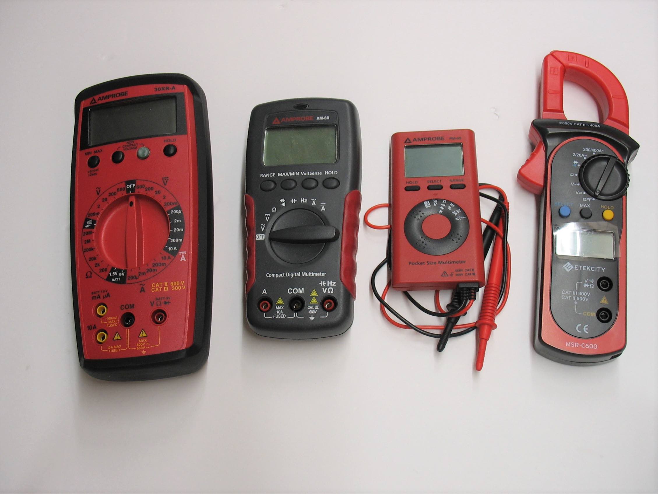

A digital multimeter, although this one does not automatically range through relative scales of each function, in other words, it’s non-auto-ranging.
