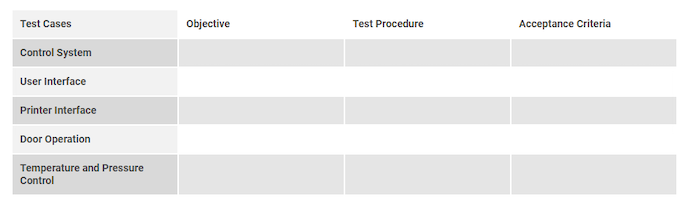

sample checklist for factory acceptance test
Figure 2. Sample Form for FAT Test Cases. Image courtesy of Consolidated Sterilizer Systems
