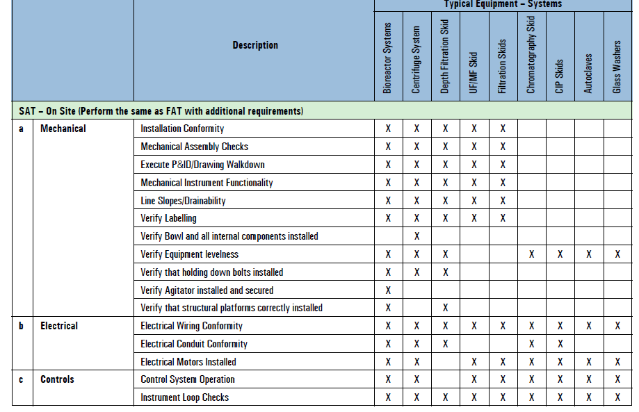

 Typical SAT acceptance criteria. Image courtesy of ISPE.
Figure 2. Typical SAT acceptance criteria. Image courtesy of ISPE
Some utilities such as steam and compressed air also cannot be provided. So during an SAT, it is necessary to verify the performance under actual environmental conditions.

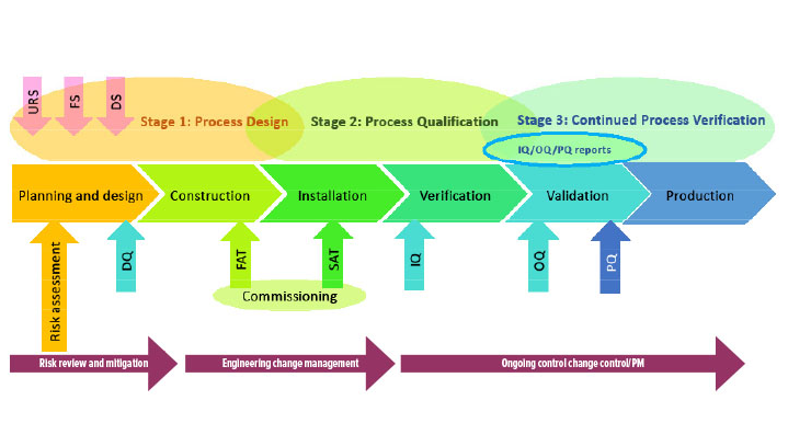

Qualification of New Equipment
In any regulated market, such as pharmaceuticals, any addition or change in process or equipment requires the equipment to go through several steps.
Steps for additions/changes in process or equipment.
Figure 3. Steps for additions/changes in process or equipment. Image courtesy of ISPE.
Generally, the new equipment passes through the following steps before it becomes part of the production process:
  • Factory acceptance test
  • Site acceptance test
  • Validation activity
