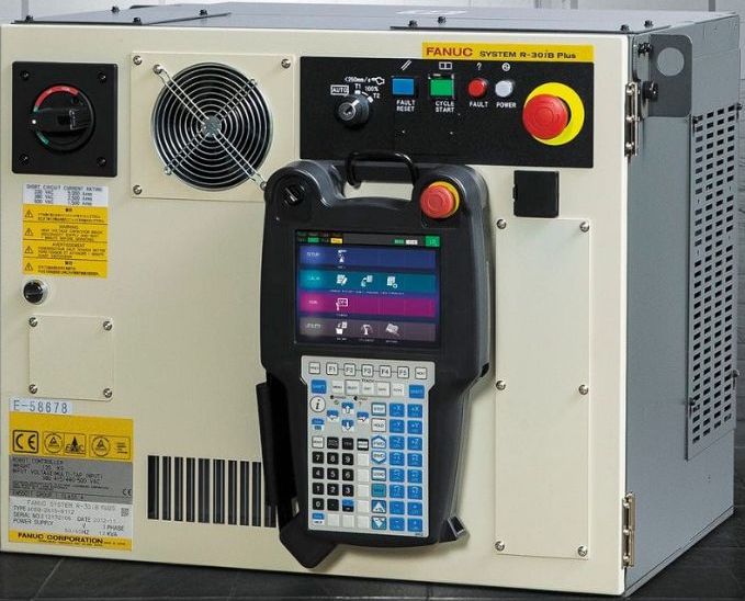

FANUC Control cabinet with a FANUC teach pendant
Figure 2. Control cabinet with a teach pendant that can be used to move a robot in order teach motion paths in a coordinate system. Image used courtesy of FANUC

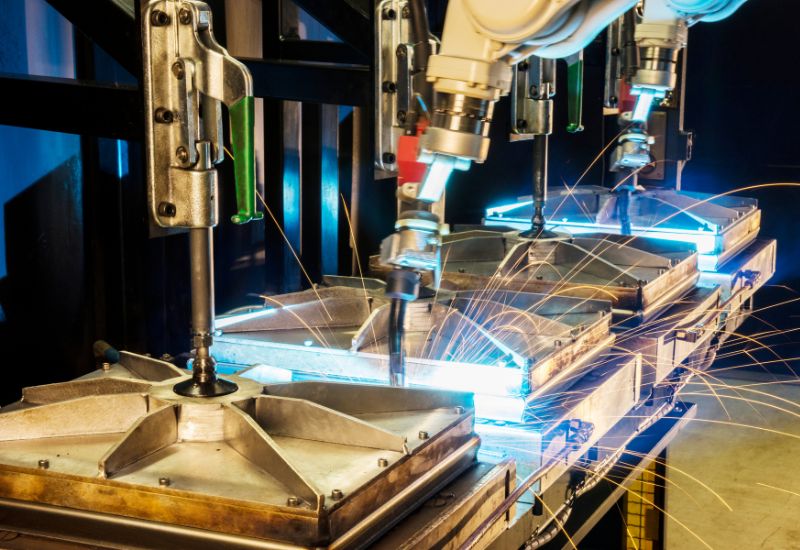

A welding robot requires careful programming
Figure 3. End tools are simple to program; however, they require caution when testing to avoid potential collision and damage. Image used courtesy of Canva
