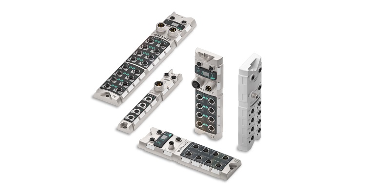

Figure 1. Examples of IO-Link blocks with Ethernet, PROFINET, and other Fieldbus interfaces. Image used courtesy of Balluff

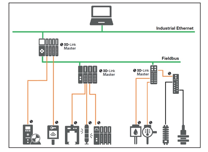

IO-Link topology
Figure 2. An example system overview of IO-Link under a Fieldbus network. Image used courtesy of IO-Link
IO-Link Infrastructure
An IO-Link system consists of three components; IO-Link master, IO-Link sensors, and the main system controller. All the sensors will connect to the master (the orange networks above) and the master will connect to the controller network (shown in green above). Some masters will reside in an electrical cabinet, but more commonly you will find the master in the field close to the I/O components. Some masters can be added as interface cards within distributed input and output racks.
IO-Link VS Other Protocols
The IO-Link protocol is a device-level point-to-point protocol, so it is restricted to only one device per port. This is different from a Fieldbus technology that would have many devices all connected in star or ring topology with messages being sent out on the network destined to specific devices.

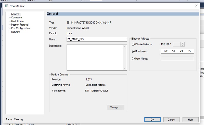

Each PLC will have a slightly different way of adding Fieldbus devices, with datasheets often providing instructions. In most cases, we can locate an EDS (electronic data sheet) directly from the product site or add a generic ethernet device in the hardware tree, providing the datasheet mentions assembly size data for input, output, and configuration.
Setting up IO-Link
Figure 3. Adding the IO-Link master device via the Studio 5000 automation software.
Each IO-Link port contains configuration data, input data, and output data which can be used to set the port as a discrete input or output or to monitor sensor values. If the device is an output, like an actuator, the output block can be used to control the device. Each IO-Link device will have a datasheet that lays out the mapping of the signals or configuration for that particular device (these start on page 69 of the user manual for this particular device, if you wish to follow along).

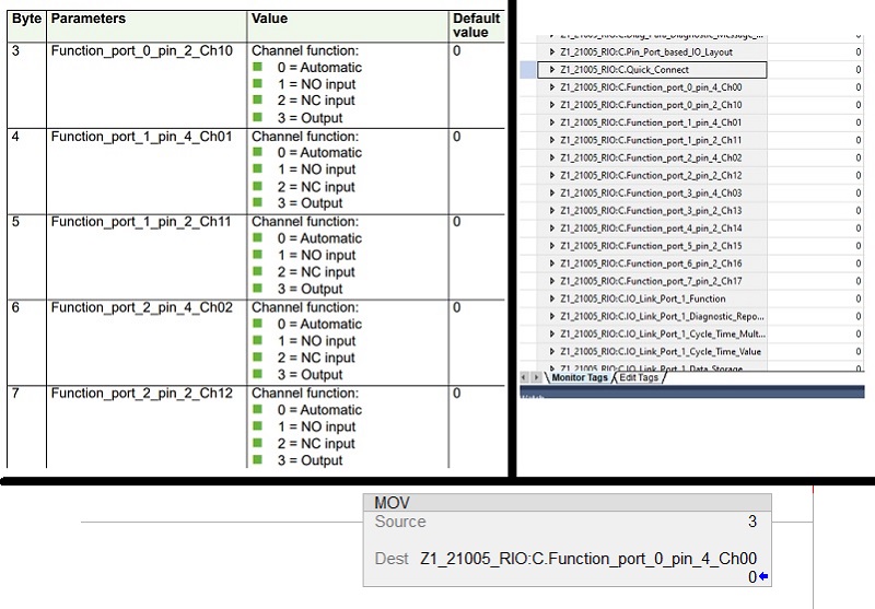

The following image provides, simultaneously, a clip of the datasheet displaying the parameter definitions, the Controller Tag database with the tag names, and the ladder logic command which sets the port (or pin) as an input or output.
IO-Link Parameters
Figure 4. IO-Link datasheet (top left), with controller tags for the new device (top right), and an example of setting the IO type via ladder logic (bottom).

Since in the previous step, port 1 was established as an output, we can write to the first output bit using a simple output instruction, as shown in the figure below.
