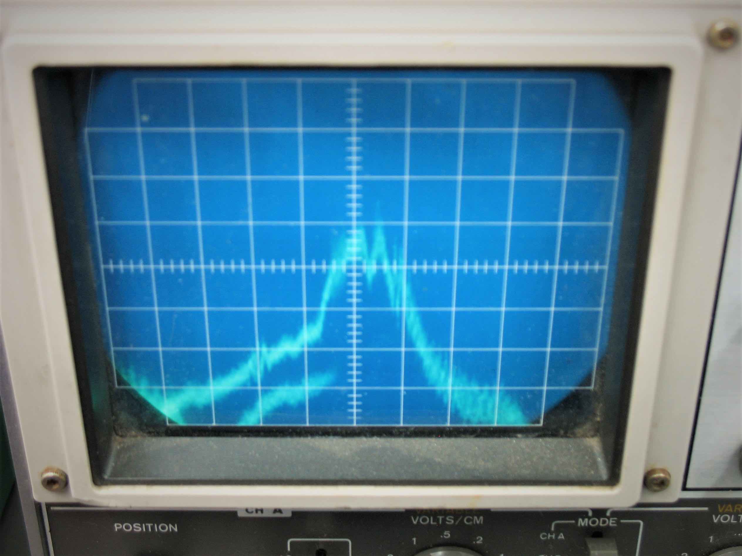

Plenty of documentation already exists to describe the exact sources and nature of many types of noise, but here is a simple definition. Noise comes from inductors, which are electrical components that store energy as a magnetic field. When the source voltage changes, a subsequent shift in the magnetic field results. That changing magnetic field will cause any nearby wires to receive an induced voltage that tried to drive current (hence the name 'inductor').
An oscilloscope screen is showing the small voltage spikes visible alongside a larger alternating wave.
If a voltage is induced on a nearby wire, that may be a severe problem for the control system. A digital or analog input on a PLC is looking for any small change in the sensor's voltage, and that change would produce a specific result output. That voltage change may come from an inductor near the cable - not from the sensor itself. The output may cause harm or damage if it happens at the wrong time.
This concept of inductance to generate a magnetic field is the primary operating principle of motors and transformers. It could be correctly assumed that an environment filled with motors and transformers will be at risk of electrical noise—the more current, the worse the problem. Although inductors generate the most interfering noise, even a wire carrying alternating current will create some noise.
Noise may occur as single events, non-repetitive signals thrown onto the wire, which would look like a quick rise and then fall of voltage, usually just for a moment when a big device starts or shuts down. Alternatively, it might be a very systematic, repetitive change in voltage of the wire introduced from a nearby 3-phase wire that will be present the entire time the device is running. Both of these noises can cause problematic results.

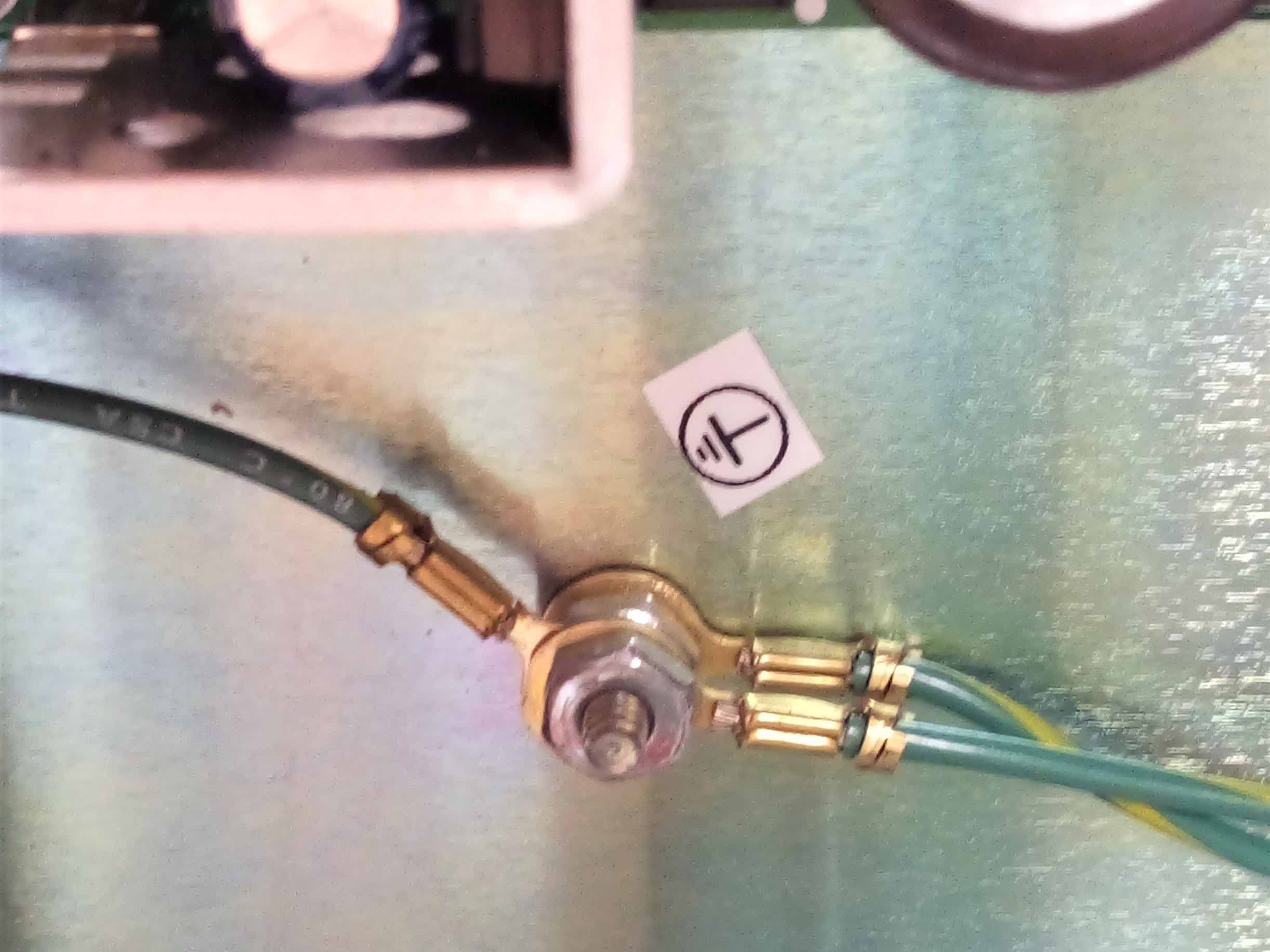

Properly Grounding your Equipment
One main culprit for the noise on a system is improperly grounded (bonded) equipment. If a long strip of ferrous metal, perhaps the steel frame of a conveyor is near a large motor, it will receive some inductance. That should be harmlessly passed straight to ground through the nearest ground bond.
If there is no ground or is not sufficiently low resistance, the entire frame will be magnetized, causing the inductance to be passed to wires nearby as noise. A simple multimeter check between the steel frame and any ground wire can indicate a properly low ohm reading.
Proper ground bonding of equipment can prevent that equipment from passing off noise from the inductive source to the sensor cables.
