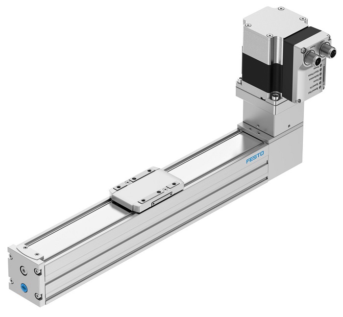

Scaling
Many companies sell actuators that will accept servo motors being mounted onto them, a common assembly is a Festo ball screw linear actuator. This actuator can be combined with an Allen-Bradley servo motor and gearbox to make a complete servo axis.

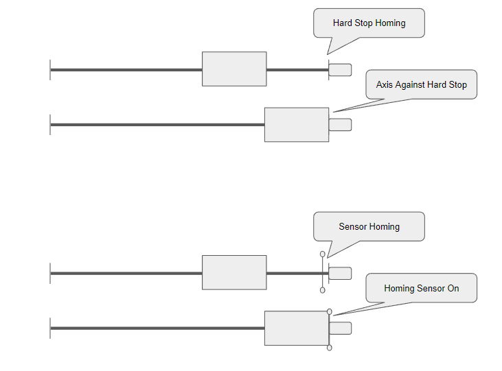

Homing against a stop vs. a sensor
Figure 3. Homing against a hard stop or a sensor. Image used courtesy of the author.
One method is called home-to-torque, this requires the axis to move slowly in a single direction, typically reverse, until the axis reaches a hard stop and the controller senses a rise in drive current, indicating over-torque when the limit is reached.
Another option is to wire a sensor, either mechanical or optical, to the drive and configure an input as a homing sensor. When the homing cycle is initiated, the axis moves towards the sensor. Then, when the drive receives the signal, the position is zeroed.
Both methods have their caveats and it is up to the designer to decide which method is best suited for the application. A final reference method is to set the current position as ‘zero.’ This method is commonly used with conveyors or applications where the position rolls over.

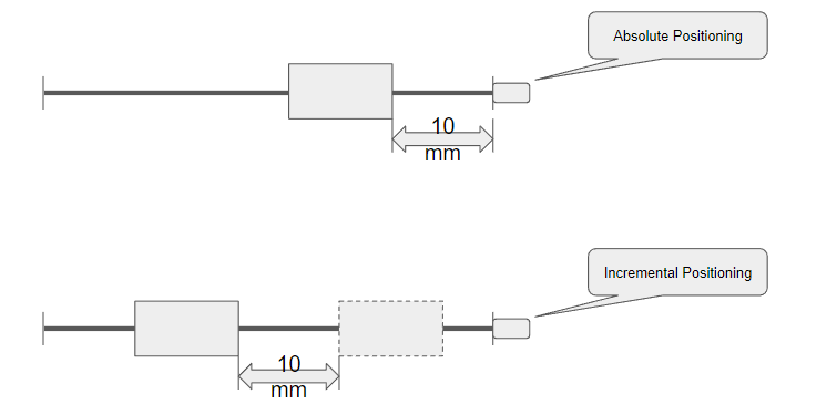

Absolute and incremental positioning
Figure 4. Absolute positioning is based on a fixed reference (top) and incremental positioning is based always on the last previous position (lower). Image used courtesy of the author.
Absolute moves are commanded moves from a zero position. If you command the axis to move 10.00 mm, the axis will move until it is exactly 10 mm away from the zero position. If you command the axis with the same position again, it will not move, because it’s already 10 mm from the zero. Once the position is reached, the axis stops at the commanded deceleration rate
Incremental (also called relative) positioning moves the axis from its current position. If we command a move of 10.00 mm, the axis will move 10 mm from its current position. If we command that same move again, the axis will move another 10 mm.

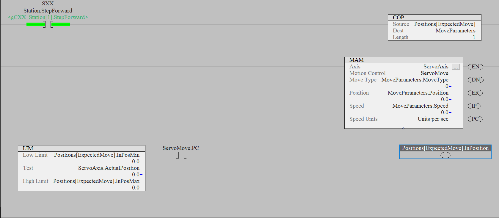

Servo ladder logic
Figure 6. Ladder logic for driving servos, including a MAM (motion axis move) instruction. Image used courtesy of the author
We need to think about how many target positions we need to have.
For my own program design, I like to create a UDT with all the parameters of the move block that will change per position and call it ‘ServoParameters.’ It doesn’t matter if you are moving incremental, absolute, or rotary, the same move block is used.
I then create a tag called ‘ServoPositions’ which is an array of the servo parameters UDT. I now have an array of parameters that I can indirectly address in my logic which references the commanded position. Command position 1 would index 1 of the positions array, and all the parameters in that index would be taught from the HMI.
Servo Drive Alarms
Many alarms are standard or generic with servo drives. Typically the control system will generate an alarm code that can be searched in the documentation. I recommend using a generic servo alarm that is displayed on the HMI and reporting the device alarm code with it. Machine-generated alarms for servos are typically things like: “Not in position,” “Tooling Not Clear,” and “Command Did Not Complete.” These are alarms that are tracked internally within your control program
Command From A Sequence
Your sequence should be simple and clean so that it is easy to read and understand, try to keep move blocks out of the sequence routine. I like to move command numbers into an “Expected” tag and then use that tag as a pointer in my positions array tag. When the machine is stepped forward in the sequence, I’ll copy those move parameters into the move block and initialize the move. Once the move has been commanded, I’ll track that the axis is moving and when it completes. If the axis doesn’t reach the position, or if the axis doesn’t start moving, I can stop the sequence with an alarm.

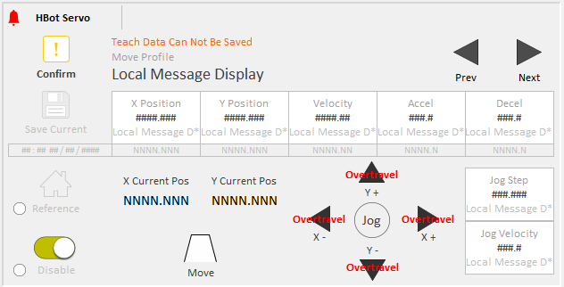

Example HMI screen for motion
Figure 7. HMI control for a servo movement program. Image used courtesy of the author
HMI Control
Controlling your axis from the HMI allows integrators and maintenance staff to teach positions and troubleshoot issues without connecting to the PLC. This is where your jog move comes in handy. Your axis control should include a jog forward, backward, continuous jog, and incremental jog.
When the operator is ready to save the position, use the reverse logic we used to command the axis. A pointer set from the HMI indirectly addresses the positions array, and a button on the HMI copies the entered data into the array data. You now have a fully functional servo axis system.
