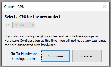

We will start a new project, with the next step being the CPU selection and defining the I/O modules.
I chose to complete this step first since some program commands are only available with select CPU versions, and I would rather know that my project is definitely compatible with my current CPU.
browse server
Figure 2. Choose CPU.
My CPU is indeed a P1-550, the dual-EtherNet CPU from the basic Productivity 1000 series. Moving into Hardware Configuration, I can define the combination input/output module which is installed on my benchtop unit.

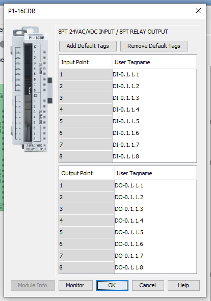

Once in Hardware Configuration, double-click on the image of the CPU in the ‘Local Base Group’ window. From here, you can drag and drop the proper module(s) into the proper locations according to your hardware setup. Since I only have one P1-16CDR (16 terminals, combo digital in/relay out), that will be my hardware.
adding unique alias tag names directly when the module is added to the project
Figure 3. Adding unique ‘alias’ tag names directly when the module is added to the project.
When I add this P1-16CDR, I can choose to write the names of the real-world I/O tags right here in the hardware definition.
For example, if the first input (DI-0.1.1.1) is a green button, I can just write ‘Green Button’ in the User Tagname column in the appropriate row, and defining tag names just got much simpler.
In my simple process, I have a green button in terminal 1 and a red button in terminal 2, as well as a single relay in output 1. I will add these tag names. Do not click OK just yet.

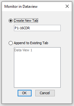

Any tags I create here in the hardware setup, or later, can be monitored to display their current boolean, integer, or string text value. If I’m creating an entire module of I/O points and I’m going to monitor all of them, I will save time by clicking the ‘Monitor’ button at the bottom of the P1-16CDR window.
When I click Monitor, it gives me the choice of adding these tags to an existing data view (which we might call a ‘watch table’) or adding to an existing one. For clarity, I usually add each module to its own tab, then use the default ‘Data View 1’ tab to monitor the collective few tags that are the most critical and valuable for my process.
adding the tags to a watch or data view table
Figure 4. Adding the tags to a watch or ‘Data View’ table.

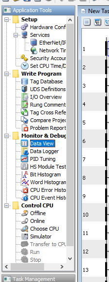

In the main programming window, I can always find these data view tabs on the left Application Tools tab of the screen.
locating the data view tab to monitor tag values
Figure 5. Locating the data view tab to monitor tag values.

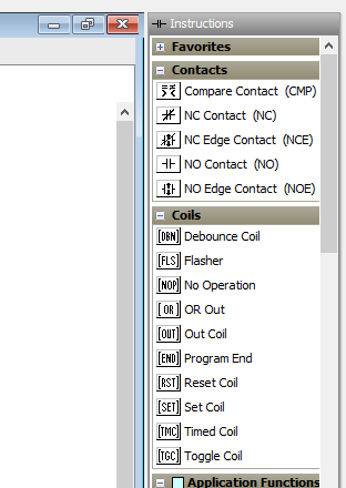

Input and output instructions (as well as timers, counters, math, etc.) are stored in an instruction catalog on the far right side of the screen. The input and output contacts and coils are near the top.
In this view, you should notice that NC Contact and NO Contact most closely match the often-used instruction in every language, like the XIO and XIC in Rockwell’s Logix studio software.
The most common momentary output (OTE) is referred to as the ‘OUT’ coil you can see about halfway down the ‘Coils’ folder.
input and output instructions
Figure 7. Input and output instructions.
To get started building an actual program, drag one single NO Contact near to the left side of the first ladder rung in the program screen, and give it the name ‘Green Button’ as you defined earlier.
Likewise, drag an OUT coil and drop it in the rung, and it will attach itself to the far right side. Give it the name ‘Relay 1’ as you defined earlier.

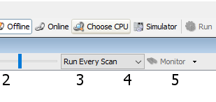

Click the Choose CPU button near the top center.
choose cpu button
Figure 8. Choose CPU button.
If only one PLC is connected, this USB connection will be the only entry on the list. You may safely ‘Connect’, and if prompted to use the PLC or PC program, be sure to use the PC program unless you want to upload the program and lose the hard work you have just done.

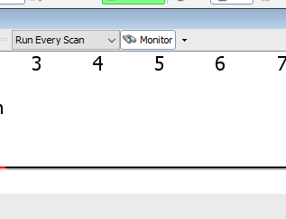

Once the program is loaded, use the ‘Monitor’ button, which looks like a pair of binoculars near the top of the program window, to view the online, live status of the commands.
monitor tags live in the ladder logic
Figure 10. Monitor tags live in the ladder logic.

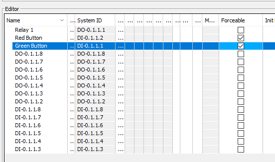

In order to test the program using actual literal tags from an I/O module, you must allow the input tags to be forceable. Double-click on the Tag Database tab to find your two inputs.
tag database
Figure 13. Tag Database.
Once you have located the Red and Green Buttons, click the checkbox to allow them to be forced on and off.

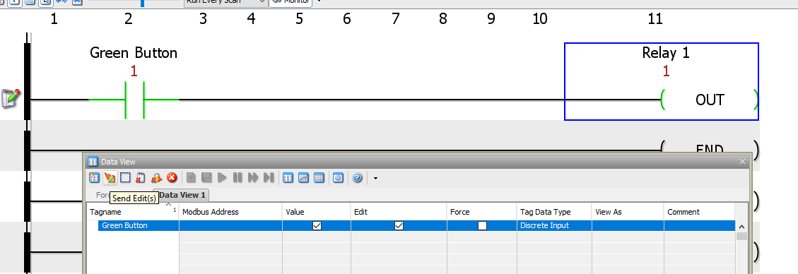

Figure 14. Allowing inputs to be ‘forced’ on and off.
Now, go back to that Data View tab, find the Green Button, and you can Edit it ‘on’, then Send Edits and watch the ladder logic respond just as it would in real life!
forcing to simulate logic
Figure 15. Forcing to simulate logic.
