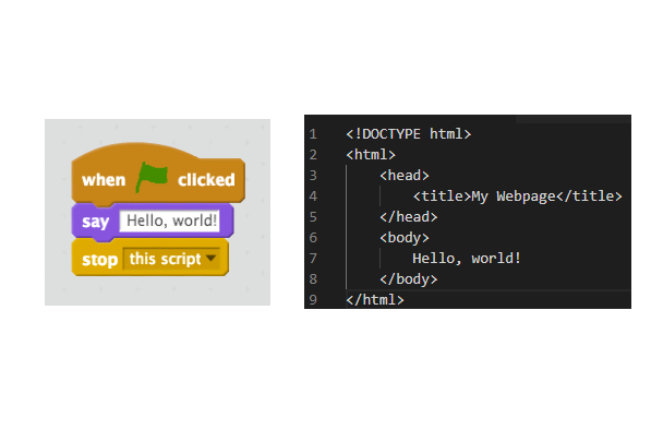

One of the most well-known programs that people are familiar with is Hello World - a simple program that displays the text, "Hello World." The lesson continues typically by changing the fonts, size, color, and message. From here, things can get very complicated. Companies and institutions such as Google and MIT might have changed the game when they started working on a new graphic language to inspire kids to start coding.
One of the first programs people learn in two languages. On the left is MIT’s Scratch and the right is HTML. Images courtesy of Massachusetts Institute of Technology (MIT).
They offer a free lecture from Harvard explaining how to use Scratch. Additionally, they offer a list of YouTube videos offered from Harvard on introduction to computer science.
Often called block programming, this language is an integrated development environment that puts executable actions into modular graphic blocks. They are like preprogrammed Legos that snap together to build custom programs without any prior coding language knowledge. While this is a simple example, it is easy to drag and drop these blocks compared to typing line after line of code.

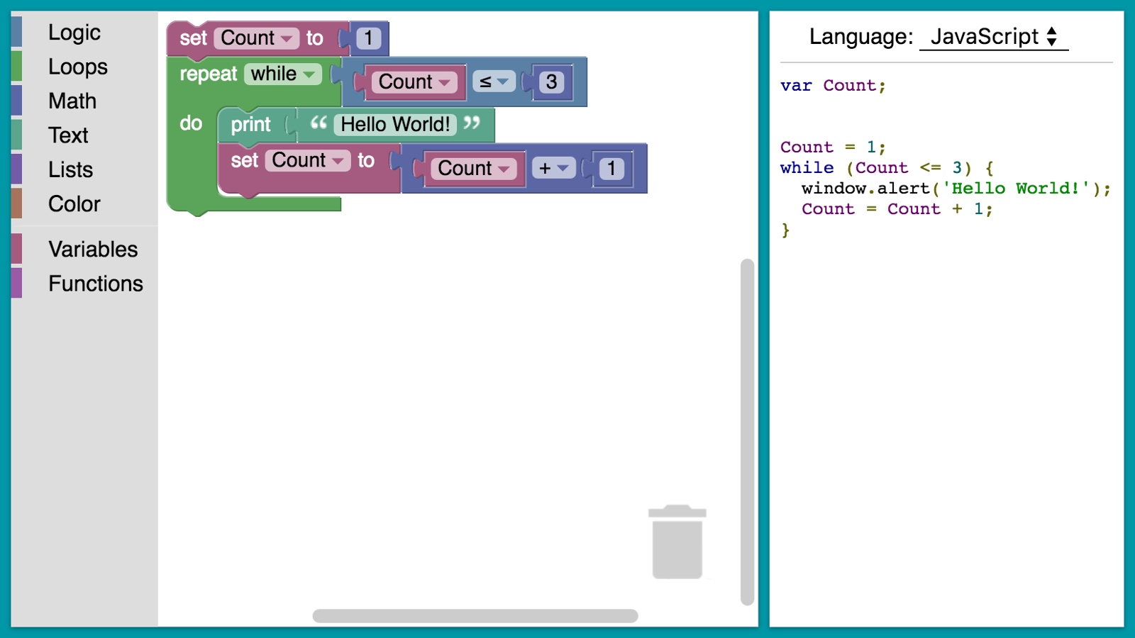

Google BlocklyMIT Scratch, and other block programming languages have quickly moved from teaching kids to code, to a serious industrial language. While ladder logic is most mechanical engineers' introduction to programming, it is limited. This new graphic language is not designed to replace ladder logic, but it will help mechanical engineers, technicians, and others with no programming experience expand into complex tasks such as robotics.
The Google Blocky interface. Image courtesy of Google Blocky

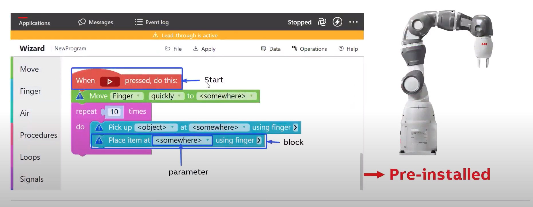

Developing its block programming language and offering collaborative robots with manual programming, ABB brings some great things to its already extensive range of products. While I haven't seen anything as developed as UR Academy, there are many free webinars, tutorials, and YouTube videos to walk anyone through this technology.
A screenshot of a pre-recorded webinar from ABB Robotics, explaining how to use the Wizard programming tools. Image courtesy of ABB.
