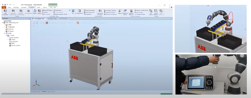

If you are thinking of using technology that uses preprogrammed blocks from libraries or platforms, check out a webinar from ABB. The link starts about nine minutes in, where they discuss installation and getting started with ABB Wizard.
A screenshot of the ABB Wizard interface. Screenshot courtesy of ABB
Additionally, the license is free until the end of the year. While these programs are similar, changes in toolboxes, graphics, or blocks may cause a slight learning curve if you need to change platforms between learning and integrating.

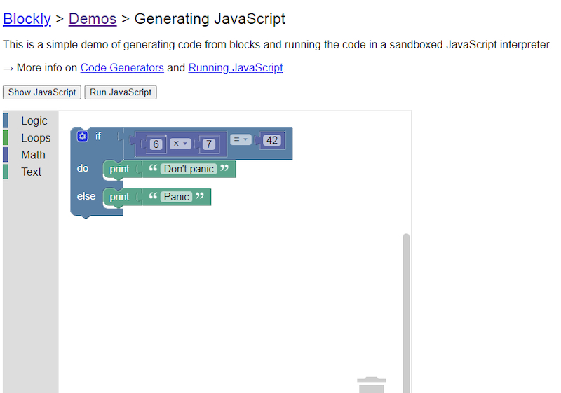

A valuable feature in many block-based programs is they can display the code presented in different languages as you build. If you check out Blockly Demo, you'll see the JavaScript Generator pictured in Image 1. You can see this by selecting “Show JavaScript.” A dialogue box will pop up to show the code.
A screenshot showing the page mentioned above. Image courtesy of Google Blocky

In the demo presented in Image 1, The column - Logic, Loop, Math, Text - is the toolbox that will help you define and render your own blocks of code is easy to understand syntax.
You can select a block and drag it into the workspace to the right. To get rid of blocks, you can select and drag it to the trash can in the bottom right of your screen, or select it and use the delete or backspace key on your keyboard.
