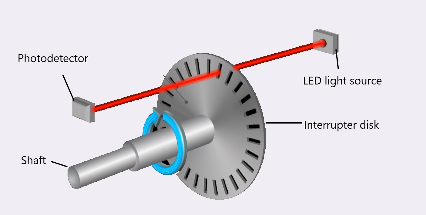

Optical sensing is a widely-implemented technology for encoders. An interrupter disk with evenly spaced cut-outs is coupled to the rotor of the encoder. An LED light source with a photodetector is aligned with the cut-out channel of the interrupter disk. The photodetector produces a pulse when the light passes through the cut-outs when the rotor rotates. The output of an encoder’s digital signals depends on the number of channels in the interrupter disk.
Inside a single channel rotary encoder
Figure 1. Inside a single channel rotary encoder. Image courtesy of Ryan VanOtterloo
In most cases, at least two channels are cut out on the interrupter disk. Encoders with higher resolution requirements have multiple channels, sometimes up to a dozen. The photodetector outputs a pulse of maximum voltage when light hits it and there is no voltage when there is no light. Therefore, the output from the encoder will be digital signals. If the encoder has a single channel interrupter disc, there is only a pair of output cables.
A dual-channel interrupter disc has two sets of output cables. The number of output cables is twice the number of channels on the interrupter disk. The digital output is used to calculate speed, angular shift, and direction of the motor.

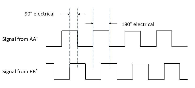

The cut-outs on the interrupter disks are designed in such a fashion that the output signal from one channel will be, in equal amounts of time, high voltage and low voltage. The output from the encoder can be observed as a square wave with a 50-50 duty cycle due to this reason.
The duty cycle is a fraction of the period in which the signal is active, where period refers to the time taken to complete the on-off cycle. The two channels in the interrupter disks are designed in such a manner that they are offset 90° from each other. This offset helps to distinguish between the clockwise and counterclockwise rotation of the rotor.
One high voltage or low voltage section represents 180° of an electrical rotation. Half of that duty cycle represents 90° of an electrical rotation. The output cables of the encoder are connected to a dual-channel oscilloscope to observe the output waveforms and should look like the image shown in Figure 2.
Signals from the two channels
Figure 2. Signals from the two channels
If the signal from AA` has the same amplitude and frequency as the signal from BB` with a 90° shift, the encoder is working correctly. If not, the encoder needs to be repaired or replaced.
