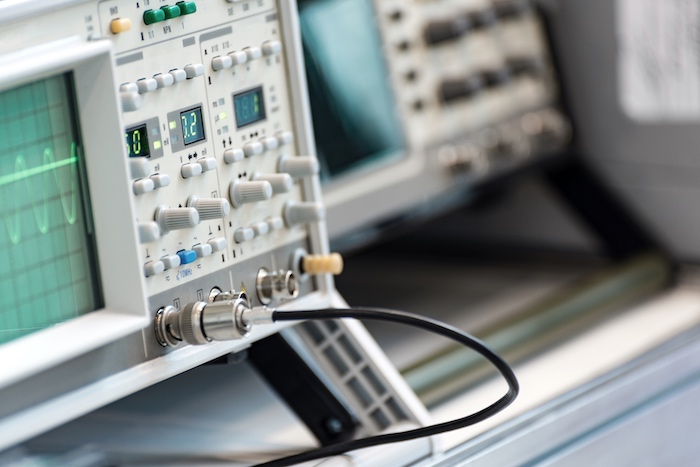

While designing or implementing a new resolver, it is useful to identify the operational limits of the component. These simulated tests can be done in an enclosed test environment to minimize any potential downsides while conducting the tests. The excitor of the resolver is connected to a signal (waveform) generator. The output from the sine coil and the cosine coil can be observed through a dual-channel oscilloscope.
Signal generators can be used to test the limits of a resolver.
Figure 1. Signal generators can be used to test the limits of a resolver.
Known errors are added to the input signal to check whether the resolver can withstand them. If the resolver fails, the design needs to be altered or another resolver with suitable specifications needs to be used. In addition to adding errors, the frequency/amplitude/waveform shapes can be altered to observe when the system fails.
The output waveforms should be verified if they meet the specifications of the resolver being tested. The sine coil output has to be leading or lagging the cosine coil output according to the direction of operation.
