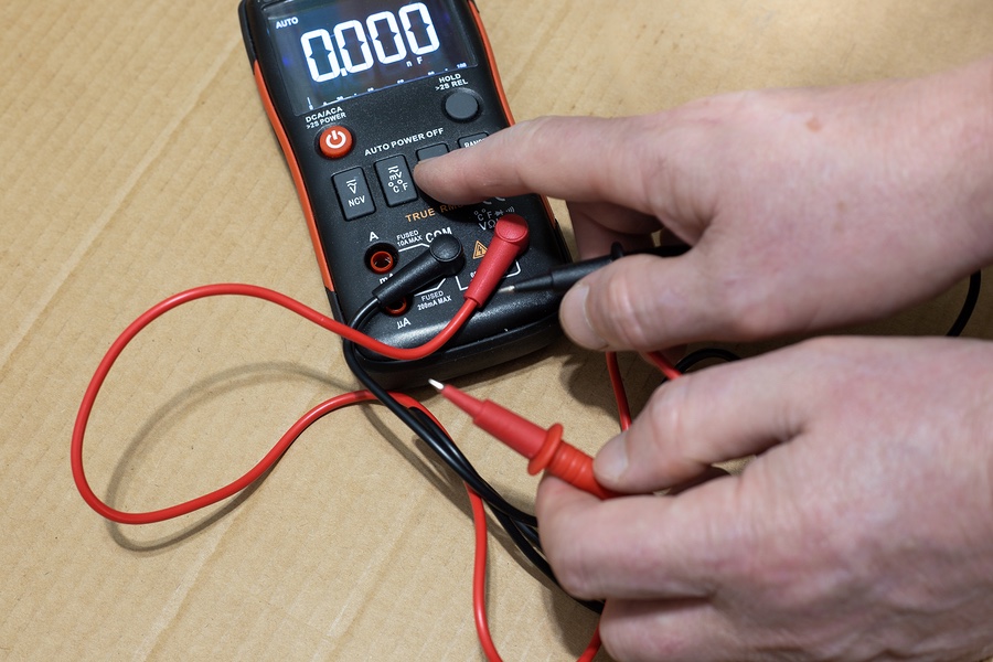

On the front of most meters, there will be a set of test lead connections. The black one will always be the COM or common connection point for all measurements. One red will be for voltage, resistance, and other tests. A third and usually fourth point will be reserved and marked for mA and A, or milliamp and amp current tests.
Many meters will sound an alarm if the function dial is set to the amps check, while a test lead is not in the correct port or the other way around. The connections and functions must match. If this beeping tone sounds, check to make sure the leads and the function set are correct.
Most of the time, one of the current test ports, the one marked mA, will also include a maximum safe number of milliamps. If you are measuring a small current, use this port. If you are measuring larger amperages, use the one marked A for amps. This will be discussed further a bit later in the article - it’s a very important topic.

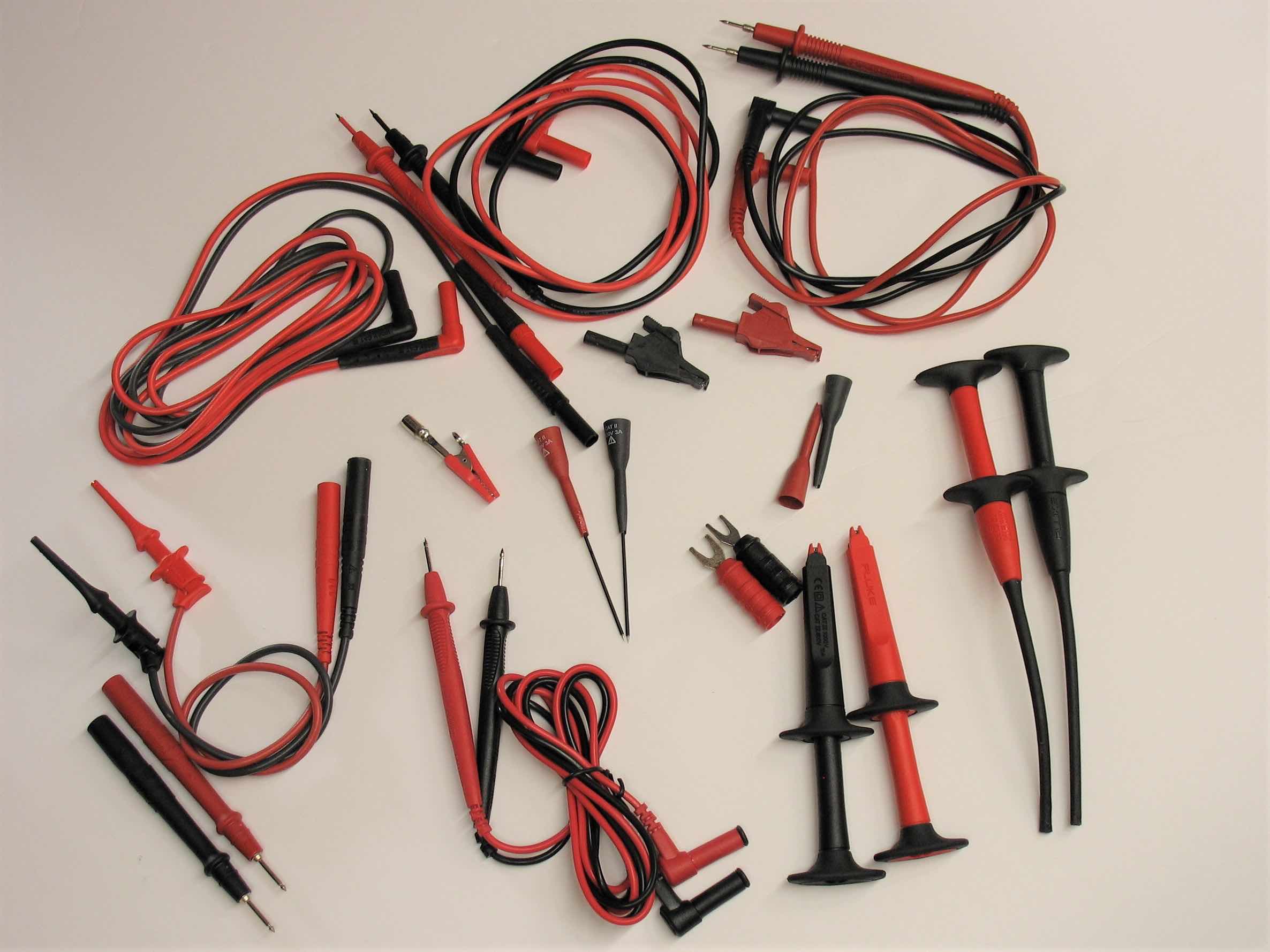

An assortment of various test leads and attachments.
