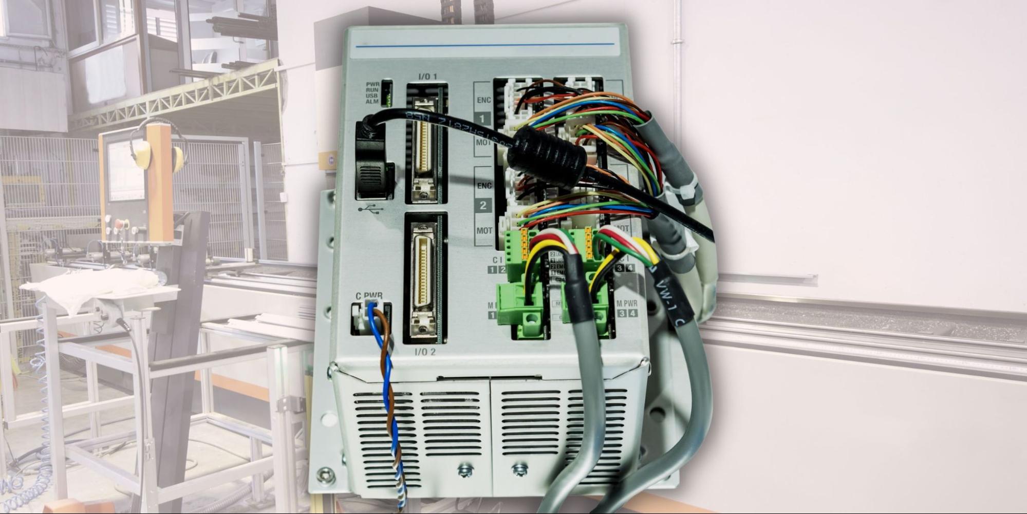

analog outputs are found on many devices, from programmable logic controllers to motor drives to PID controllers
Figure 1. Analog outputs are found on many devices from PLCs, to motor drives, to PID controllers.

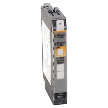

1734-OE2C Point I/O Output Module
Figure 2. Allen-Bradley 1734-OE2C Point I/O Output Module. Image used courtesy of McNaughton-McKay

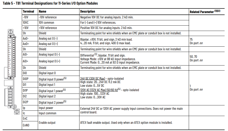

When choosing an analog output, there are two types to consider, voltage or current. The voltage output will typically be 0-10 VDC or (-)10-(+)10 VDC and is quite common for parameter settings. Current outputs usually come in 4-20 mA but can also come in 0-20 mA. The deciding factor as to current or voltage will rely entirely on the device that will be reading this signal. If connecting to a VFD, check the manual for input terminals. It is not uncommon for a device to support both current and voltage inputs, but it might require the configuration of the device or the use of separate terminals.
I/O pin designation for typical motor drive unit
Figure 3. I/O pin designation for a typical motor drive unit. Note the Ao0- and Ao0+ indicating the analog output. Image used courtesy of Rockwell Automation

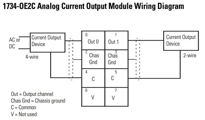

Current - Using the Allen-Bradley 1734-OE2C as an example, we can see from the diagram below that two channels can be wired in two different ways. The diagram shows a 2-wire connection to channel one and a 4-wire to channel zero. Both devices are wired using a shielded cable with the drain wire connected to terminals two and three.

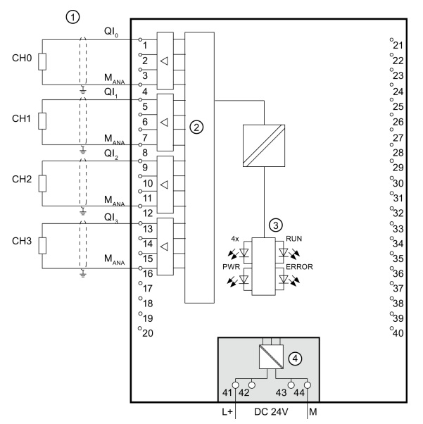

The signal that varies in current is connected to terminals zero and one, with the common (reference signal) being connected to terminals four and five. Another example would be the Siemens analog output module 6ES7532-5HD00-0AB0. This particular module can be configured to output current or analog signals.
Below is the wiring diagram for the current output configuration. Channel 0 has its output signal on terminal one with the reference signal on terminal three, and there is no provided terminal for the drain wire.
4-wire and 2-wire current outputs
Figure 4. 4-wire and 2-wire current outputs. Image used courtesy of Rockwell Automation
2-wire analog output schematic
Figure 5. 2-wire analog output schematic. Image used courtesy of Siemens

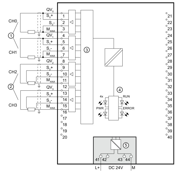

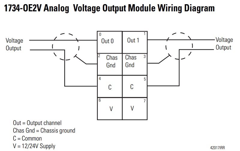

Voltage modules are wired similarly, only polarity will sometimes be indicated on the drawing. The Allen-Bradley module uses a 2-wire connection with the signal wire again connected to terminal zero and one. The Siemens example has a little more wiring when using the voltage configuration. The drawing below shows two configurations, a 2-wire connection without compensation for line resistance and a 4-wire with compensation for line resistance.
2-wire voltage output connection without compensation for line resistance, which can create errors between the sent and received signal
Figure 6. 2-wire voltage output connection without compensation for line resistance, which can create errors between the sent and received signal. Image used courtesy of Rockwell Automation
2-wire (1) and 4-wire (2) connections on an analog output module
Figure 7. 2-wire (1) and 4-wire (2) connections on an analog output module. Image used courtesy of Siemens
