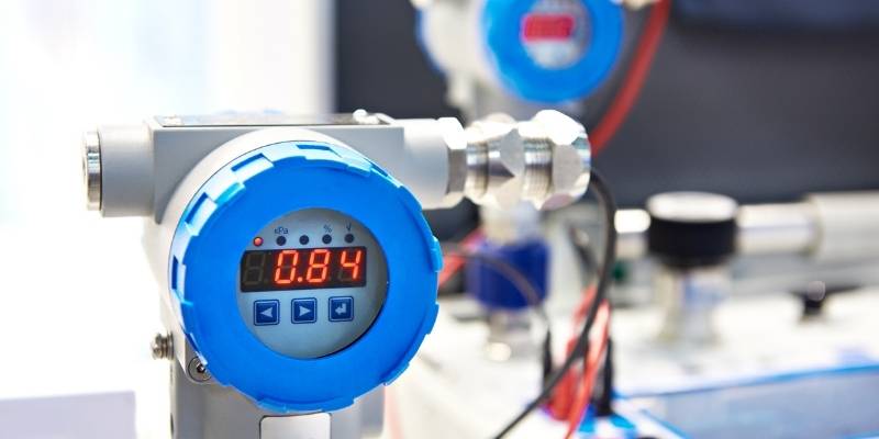

Analog sensor
Figure 2. Analog signals are often used in fluid systems with pressure, temperature, and flow rate always being analog signals. Image used courtesy of Canva

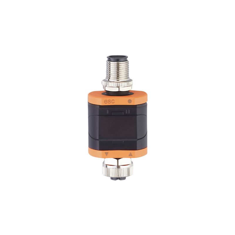

There are many different types of analog to digital converters on the market today. Some come in the form of chips, but for the industrial engineer, the converters are more likely to be integrated directly into the microcontroller or system controller in your current project. These will likely be in the form of analog input modules for a PLC or remote I/O system. Even VFDs and motion controllers will almost certainly have one or two built-in analog inputs.
There are other ADCs that will convert raw analog values into an industrial protocol to be sent across a network. Some manufacturers make analog to IO-Link converters, while others may produce analog to ethernet converters which could be Ethernet/IP or ProfiNet. Scaling may or may not occur in the converter, which means the transmitted value may be in the range of 0-1024, or 0-65535, or the value may represent the original voltage of the sensor, between 0-10 volts. Each converter will be slightly different and you will need to refer to the datasheet to determine the scaling that needs to be done in your control system.

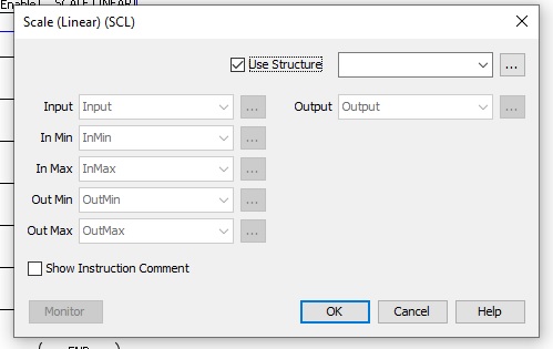

If a calculation is required to obtain the actual real-world value of the sensor, it can be accomplished in two ways, either with built-in functions or manually.
If the system is a modern PLC or microcontroller, it is likely to have a mapping function (likely called ‘map’ or ‘scale’), where a command or function block compares the current analog value to the minimum and maximum process values and calculator the current value. In the background, this process is a linear regression which can be done quite easily with a manual calculation if needed.
Analog to IO-Link converter
Figure 3. Converter between analog signals and an IO-Link Field bus. Image used courtesy of IFM

ADC Scaling Command
Figure 4. Example of a scale command using linear regression. Both the input minimum and maximum, as well as output minimum and maximum, must be known, and the analog value can be used as the process input.
