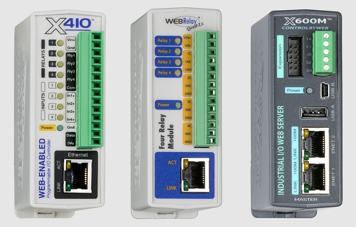

Various I/O controllers
Figure 1. Examples of the I/O controller product catalog. Image used courtesy of ControlByWeb
Each controller is designed for different I/O functions, like digital inputs and relay outputs, analog inputs, thermocouples, or protocol-specific communication nodes for data acquisition from another networked controller.

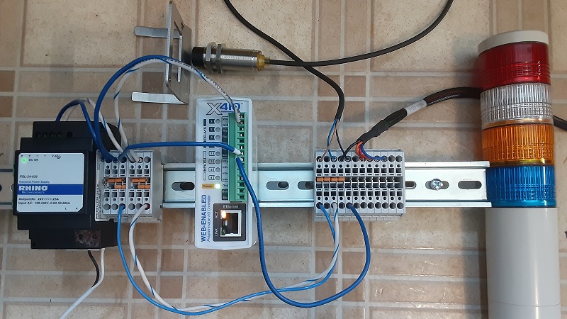

The first step, as normal, is to connect the hardware. Some of the I/O controllers from ControlByWeb can be powered with Ethernet (PoE), but most require a DC input. This X410W will be powered with a standard 24 vDC power supply.
The digital inputs are internally linked to the common DC ground, so unlike normal PLC module programming, we do not need to supply a separate common ground for the input terminals. We simply connect one PNP sensor output to In1+, and energize the sensor to ensure that the LED illuminates as expected.
If the controller is wired to a different power supply than the I/O field devices, you must connect a wire between the 0 vDC of the two power supplies.

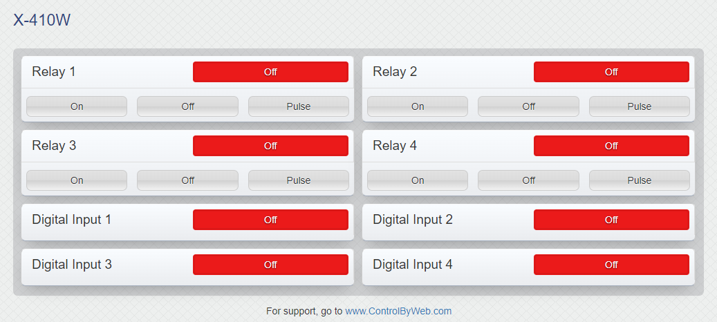

Once connected and on the same network, open a browser and type in 192.168.1.2 and you should see a screen that looks like the one below, although you may have some of the I/O points ON if your sensors are energized.
System monitor server screen
Figure 3. Accessing the web server in monitoring (non-admin) mode. Image used courtesy of the author
From this screen, we can view the I/O status, but we can’t program anything. This is very useful for monitoring as an HMI, but we need to enter the setup screen for the fun to really begin.

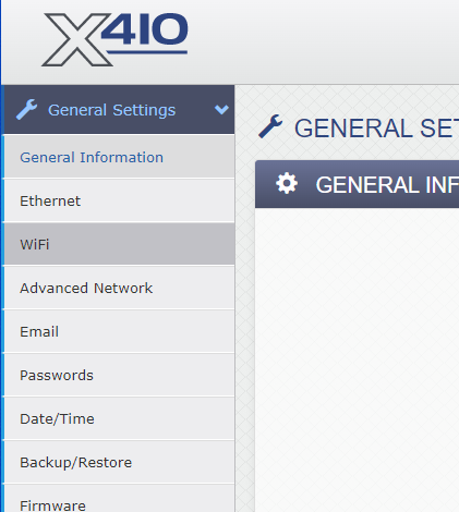

With the X410W, we can enable the WiFi so that a hardwired connection is no longer necessary. This allows you to log in and adjust the parameters from anywhere with a WiFi connection.
Access the WiFi menu from the left sidebar of the screen.
General and wifi settings
Figure 4. Accessing WiFi settings. Image used courtesy of the author
The system will scan for available networks, which will appear in a drop-down menu. You also need to provide the network password.
At this time, it might be beneficial to turn DHCP off and choose an appropriate IP address so that you can type this address into the browser to access the server across the network. In my own case, I chose 192.168.1.27 for this controller.
At the bottom of the screen, click the ‘Submit’ button to save the changes, then reboot the device.

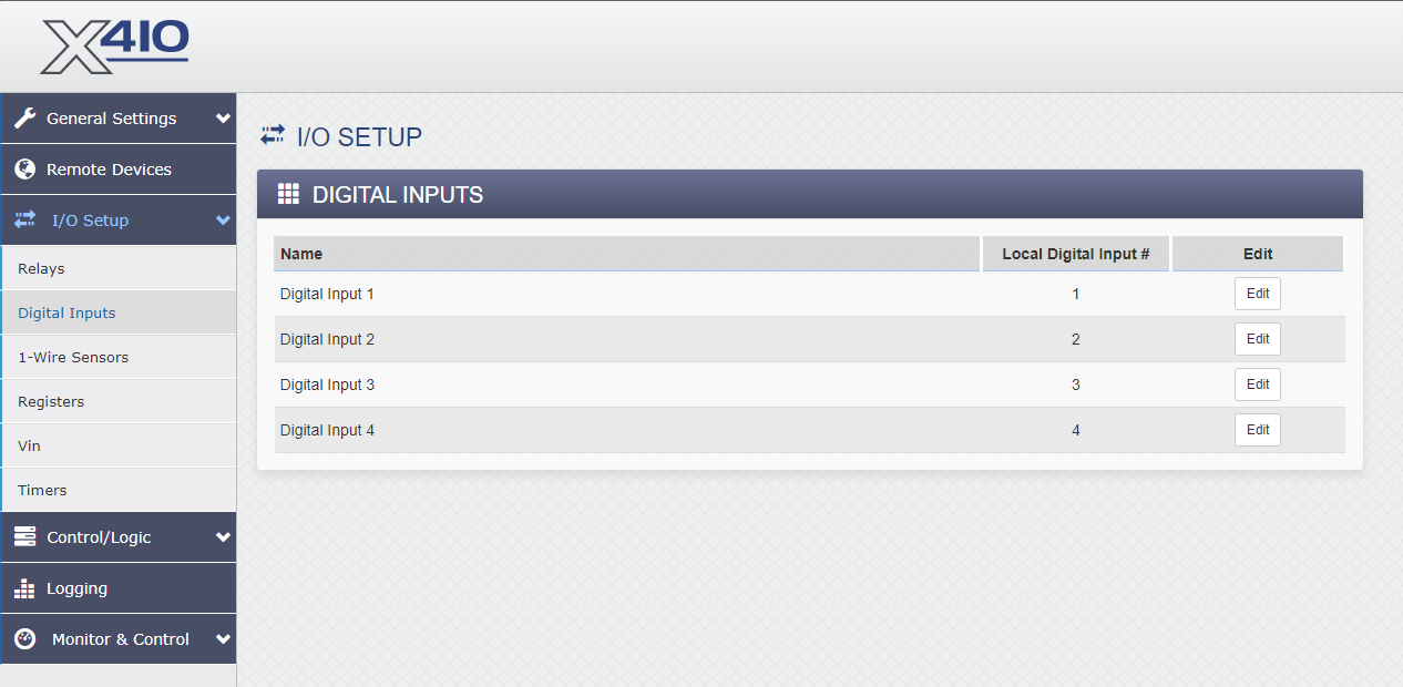

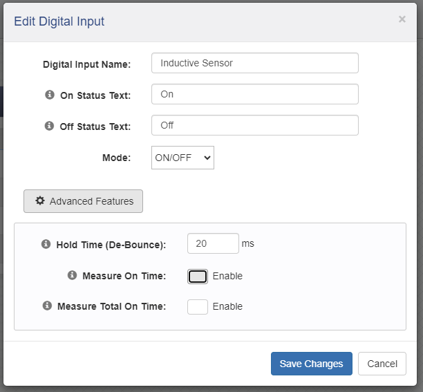

Expand the I/O Setup on the left menu and give a name to one of the digital inputs. This might appropriately be the name of the sensor, like “inductive metal sensor” in my case.
Digital I/O setup menu
Figure 5. Naming digital inputs and setting various input parameters. Image used courtesy of the author
Click “Edit” and enter the relevant info.
Editing an I/O point description
Figure 6. Input details for I/O and timing status. Image used courtesy of the author
Advanced features for inputs also include debouncing for mechanical switches and relay contacts. You may also enable measuring “On Time” and “Total On Time” which can be logged for analytical use or included in an emailed/uploaded data packet. Understanding sensor usage times can be a great source of insights.

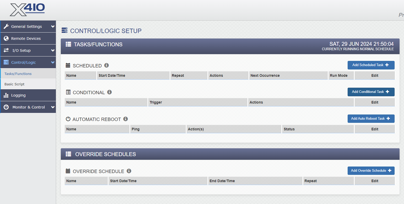

Finally, the last step is to create an I/O task, much like a rung of logic in a ladder program.
Conditional tasks are those which act when triggered by an input. Scheduled functions will perform a pre-set action at a specific time or on a recurring basis, and reboots can monitor other networked controllers and reset machines if network coms drop out.
Creating logical tasks for IF/THEN statements
Figure 7. Logic task menu. Image used courtesy of the author
Add a new conditional task and choose the inductive sensor (or your own sensor) as the if trigger condition. You can certainly add a second sensor and experiment with and/or logic; it’s quite simple.

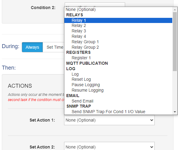

Likewise, we need to set the resulting then action statement.
Determining THEN output actions
Figure 9. Setting up the then (action) part of the if/then statement. Image used courtesy of the author
As you can see from the menu list, the condition can trigger any sort of response including relay outputs, pushing data to an MQTT, email alerts, or triggering log functions. Be careful when setting up email triggers. If you accidentally connect this action to a trigger that will pulse every few milliseconds, you will spam your poor recipient's email server and probably be blacklisted. Only use this action when there will be a significant, deliberate delay between trigger events.
