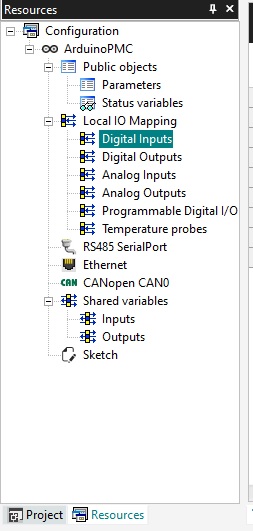

First, we must correlate the I/O addresses with logical names. For this step, the IDE provides a ‘Local IO Mapping’ menu from the ‘Resources’ tab on the left side of the screen.
resources window with I/O maps
Figure 1. Resources window with IO maps.
Here, the Inputs, Outputs, and Programmable I/O can be matched with a descriptive name that will be used in the ladder program.

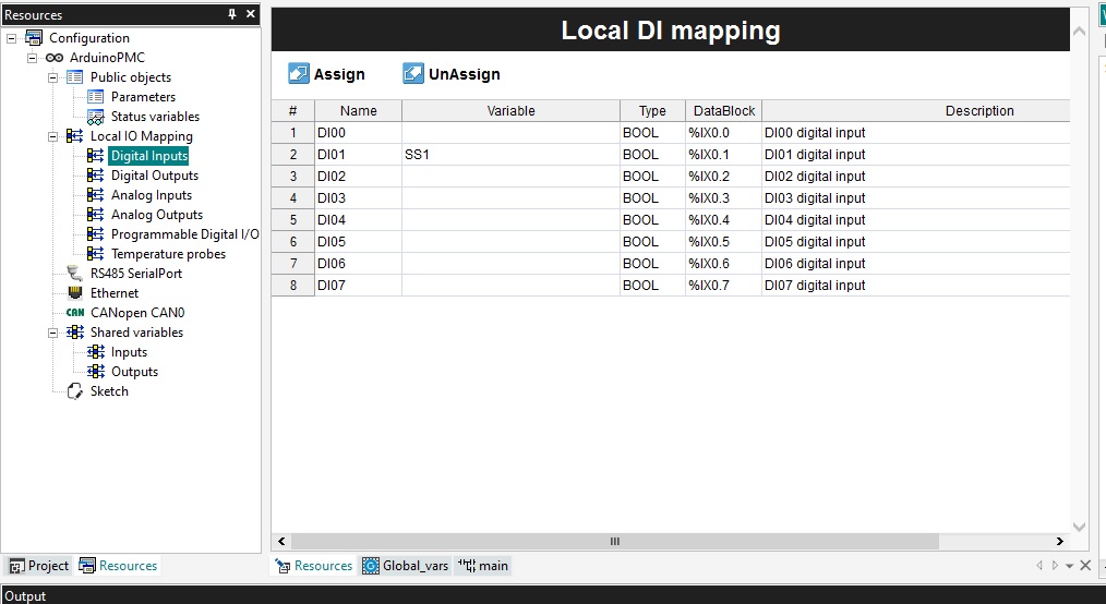

First, I open the Digital Inputs menu, find the address corresponding to the input terminal 01, (%IX0.1) and give it the name SS1, for Selector Switch 1.
Digital Inputs mapping menu.
Figure 2. Digital Inputs mapping menu.

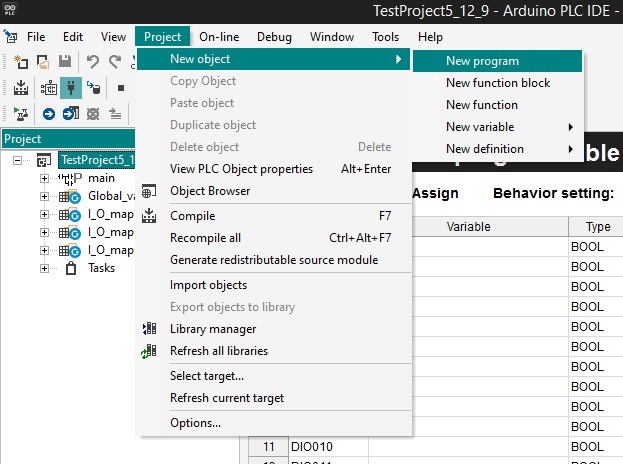

In the ‘Project’ tab, a default main program is created. To demonstrate Ladder Diagram programming, go up the Project menu -> New object -> New program. Provide it with a name and be sure to select Ladder Diagram (LD).
 Creating a new Ladder Diagram (LD) program.
Figure 4. Creating a new Ladder Diagram (LD) program.
Note: If the ‘New program’ sub-menu is grayed out, click to select the top parent of the project tree on the left Project window.

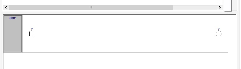

The LD program opens with a default single NO contact and single momentary output coil.

Figure 5. New Ladder Diagram (LD) default view.

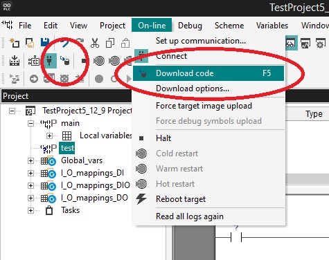

Download the program, which you should have accomplished once already in the initial setup tutorial. It can be found near the upper-left corner and in the menus.

Figure 7. Two ways to download the code to a connected controller.

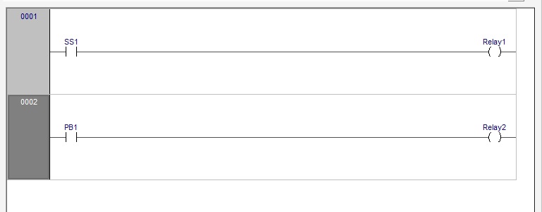

Add a new rung, also called a ‘network’, below the first one. Use the single NO contact PB1 and the output coil Relay2.
Two networks using Digital and Programmable I/O.
Figure 8. Two networks using Digital and Programmable I/O.
With this program built and downloaded, the selector switch and pushbutton should each energize a single relay.

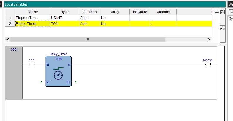

Simple Timer (TON)

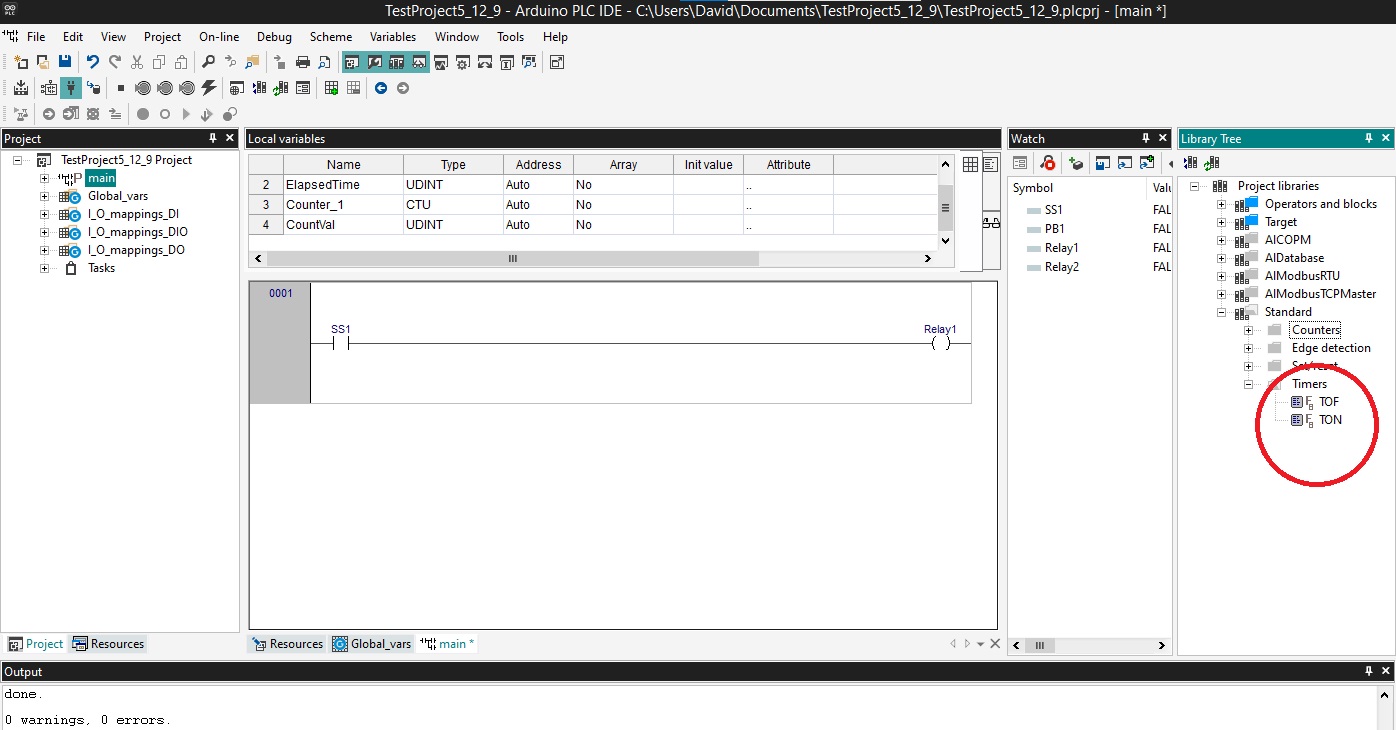

A long list of familiar function blocks can be found in the Library Tree near the right side of the page. Find and drag a TON onto your ladder rung in place of SS1. Call it Relay_Timer.
Adding a TON to a program.
Figure 9. Adding a TON to a program.
We will continue to use SS1, but this time we will delay for 3 seconds before energizing Relay1.
When you provided the name ‘Relay_Timer’, the IDE automatically created a new tag of data type TON containing the following elements: IN, PT, Q, and ET.
The TON with variable view.
Figure 10. The TON with variable view.

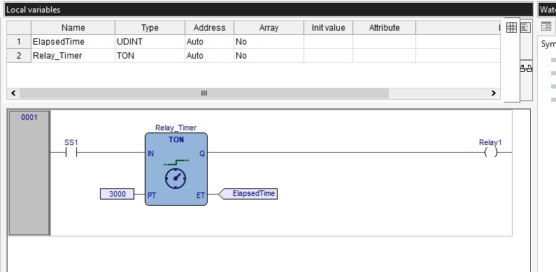

IN, the control input, will be activated by SS1.
PT is the preset time, and it can either be a constant value or it can be its own variable tag. In this example, we will use a constant value of 3000.
The Q output will energize when the timing cycle is complete (since this is a TON).
The ET variable is the current value of the timing cycle as it progresses. This is an unsigned double integer (UDINT).
I have created a new variable called ElapsedTime, with the data type UDINT to store the current elapsed time value.
Complete TON command, ready to download.
Figure 11. Complete 3-second TON command, ready to download.
Using these controls in the rung, download the program and energize the selector switch. A brief, three-second pause should occur and then the relay should energize.

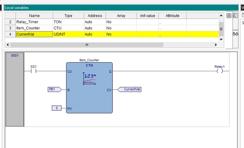

Simple Counter (CTU)
The counter is very similar to the timer, except we must have a manual reset option for the counter.
Delete the Timer and replace it with a CTU function block. This will look very similar to the timer, but it includes an ‘R’ input, for the reset.
For this reset, use PB1. For the PV (preset value) use a constant value of 5, and for the CV (current value) create a new UDINT with a name of CurrentVal.
Complete CTU instruction, ready to download.
Figure 12. Complete CTU instruction, ready to download.
-- As a side note, you can simply click and drag variable names down to the function block and drop them in appropriate places.
When downloaded, repetitive energizing of the selector switch should cause the relay to energize after the 5th switch action. If the pushbutton is pressed at any time, the counter value will reset to zero.
