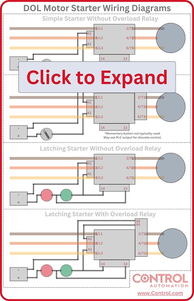

Direct Online Starter Without Reverse
A DOL starter without reverse functionality is the simplest type of motor starter, so we will discuss this wiring convention first.
Wiring Incoming Power to Contactor
Three-phase power has three legs: L1, L2, and L3. These will be wired directly to the top of the starter contactor into terminals 1/L1, 3/L2, and 5/L3. Usually, the incoming motor power connection is quite straightforward.
Wiring Contactor to Overload (OL) Relay
The overload is usually directly connected directly onto the outgoing contacts of the main contactor body with prongs that can simply be tightened down with a torque screwdriver; these are often labeled as 2/T1, 4/T2, 6/T3, as they supply the T leads for the motor itself.
Wiring Overload to Motor Leads
The outgoing terminals of the (optional) overload should have the same labels as the contactor, 2/T1, 4/T2, 6/T3, or similar. The wires for powering the motor should be connected directly to these ports.
To explain this wiring scheme, phase 1 is connected to terminals 1-2, phase 2 to terminals 3-4, and phase 3 to terminals 5-6.
Figure 2. Click to see an expanded version of the various methods of wiring a DOL motor starter.
Wiring The Control Circuit (Coil)
The control circuit (coil) needs to be wired to either an ON/OFF push button circuit or the DC/relay outputs of a PLC; contactors are never analog devices. The coil accepts the input signal to start the motor whenever necessary. In our example, we have used a 24 VDC control voltage.
Using a PLC or Electromechanical Switch
When using a PLC, the output can be directly connected to coil terminal A1, with terminal A2 continuing to the 0 VDC rail or the overload relay (explained below). The PLC can handle any latching or timing functions, so the wiring is very simple.
When using a manual pushbutton switch, most contactors provide additional terminals to aid in various circuits. A stop and start button are wired in series from 24 VDC, and then the NO auxiliary contacts (terminals 13/14 or 53/54) are connected in parallel with the start button to provide an on/off latch. This start button is then connected to the A1 coil terminal, with A2 returning to 0 VDC.
If an overload relay is provided, the A2 coil terminal is connected to the OL relay NC contact 95, and then terminal 96 returns to 0 VDC. This NC contact opens the circuit in case of dangerous overcurrent.

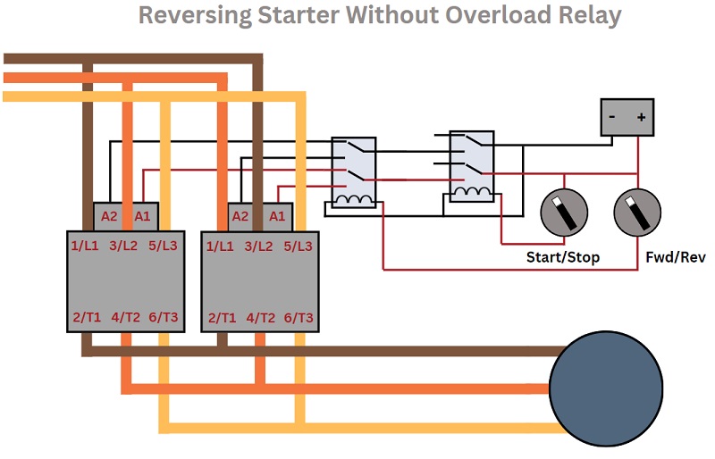

DOL Reversing Motor Starter
DOL starters with reversing capabilities are very similar to standard DOL starters. The wiring terminals are the same, with the exception that DOL with reverse uses two contactors. The extra contactor will provide the motor with reverse by switching two of the legs, effectively making the motor start in the opposite direction.
Both contactors will be wired the same, and each will require individual interlocked buttons, with one labeled forward and one reverse. When using a PLC, an extra +24VDC output will be used to supply the second coil with power from a PLC, never energized at the same time.
A mechanical or relay interlock is employed to ensure that both contactors can never be energized at the same time, while a second relay may provide on/off control, as shown below in Figure 3. If a PLC is used, simple logic may allow on/off and fwd/rev control.
The three legs of the contactors will be wired together, meaning the L1, L2, and L3 will still be the incoming power, but the terminal 1/L1 of the first contactor will connect to 3/L2 of the second. Likewise, 3/L2 will connect to 1/L1. All terminals on the other side of the contactors will be jumpered together before entering the overload. Sometimes, reversing bus bars are used, which also reverse L1 and L2 for the incoming power. Any two lines can be reversed, but for consistency, this is a common convention.
Figure 3. Wiring diagram for a simple reversing starter circuit with a relay for Start/Stop and a relay for Fwd/Rev control.
