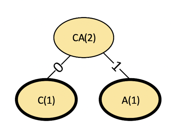

We begin by removing both the C and A symbols and forming a binary tree. Note that we label the parent node as the concatenation of symbols of its two child nodes. The number in parenthesis represents the frequency of occurrence of the symbol. The parent node can be interpreted as, “the frequency of occurrence of either a C or an A is 2," which is simply the sum of its child occurrences.
Step 1
Figure 3. Step 1 in a Huffman code.

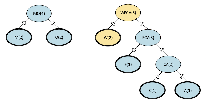

Step 3
Figure 7. Step 3 binary tree in a Huffman code.

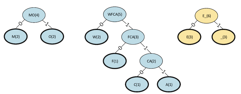

Step 4
Figure 9. Step 4 binary tree for a Huffman code.

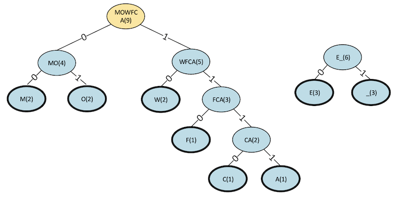

Step 5
Figure 11. Step 5 binary tree for a Huffman code.

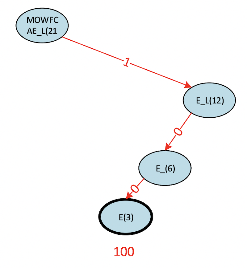

In our completed tree, all of the symbols appear as leaf nodes (with bold outlines). Codes have been assigned by starting at the root node and recording the 0/1 sequence down the path, which leads to the particular symbol. For example, the code for E is obtained, as shown in figure 18.
Figure 18. Binary tree for obtaining the code for E.

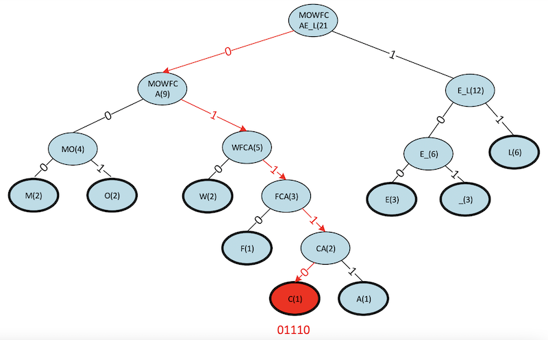

We begin at the root of the tree and follow the path indicated by the binary digits until we reach a leaf node. As you can see below, this results in the first letter of our phrase, a “C.” We then repeat the process continuing from where we left off until we have no more bits to process.
Figure 20. The final Huffman algorithm showing the first letter, “C.”
